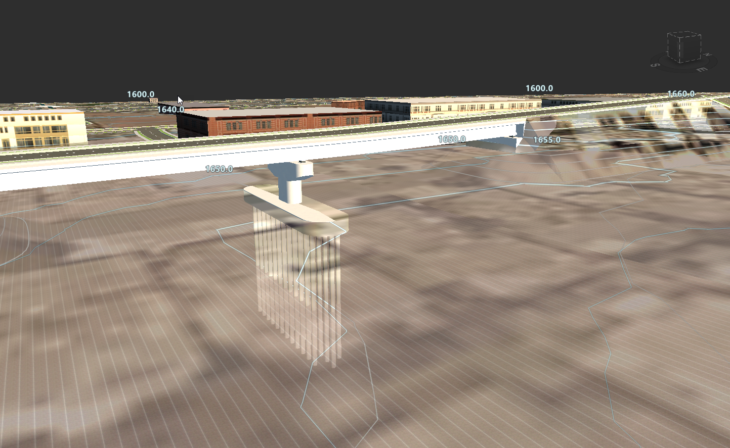

Using InfraWorks, civil engineers can add subterranean layers to their models to illustrate the thickness and density of subsurface terrain layers. Engineers can add as many layers as needed to the model with the ability to view and hide any layer in the model and adjust the opacity of each terrain layer.

The success of a civil infrastructure project is dependent on the foundation it’s built on. To build lasting bridges, tunnels, and roadways, the subsurface terrain must be considered in the design and the planning stages of the project.
Using InfraWorks subsurface terrain features, engineers can work with site surveyors to more accurately model the project environment, customizing the depth and material of subsurface terrain layers. This can be helpful in determining the stability and safety of the project terrain as well as the cost and time required to complete the project.
For example, if a road were to be built across a marshy landscape, designers would need to know the depth and material of the solid ground below the marsh. This would inform the amount of material needed for the project, whether the road will require a backfill as a foundation, as well the amount of time and work required to build the foundation for the road.

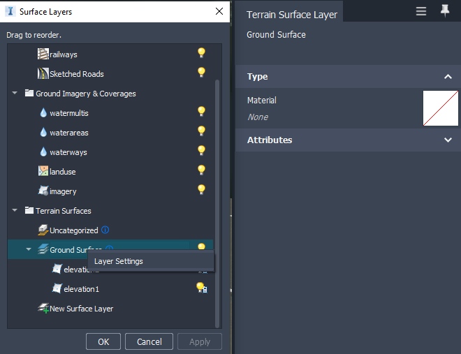

Surface layers can be imported to InfraWorks as IMX files via the Data Sources panel in the Create tab on the toolbar.
Layers can be added by clicking Manage glyph Display glyph (Surface Layers) to open Surface Layers. You can use this tool to add or modify surface layers.
surface layers
When importing surface data, Infraworks will notify you that the data is uncategorized and will not be visible. InfraWorks will then present the Surface Layer dialog asking you to categorize the data.
For Terrain Surfaces, right-click a sub-category such as Ground Surface and select Layer Settings to modify material style and related attributes such as surface opacity for that layer in the Stack.
Use show layer and hide layer to modify visibility for terrain, ground imagery, coverages, water areas, as well as roads and railways.
Note: The light bulb icon indicates that a surface layer has settings that can be modified in the stack.
Features that conform directly to the terrain (terrain, coverage, water, railways, and roads) are considered "surface layers." The Hide/Show control for those features controls their display as a group.
By right-clicking a surface in the Surface Layers menu, you can edit layer properties, including layer material and opacity.
Clicking the surface layer in the Data Sources panel allows you to configure IMX and Geolocation options.
