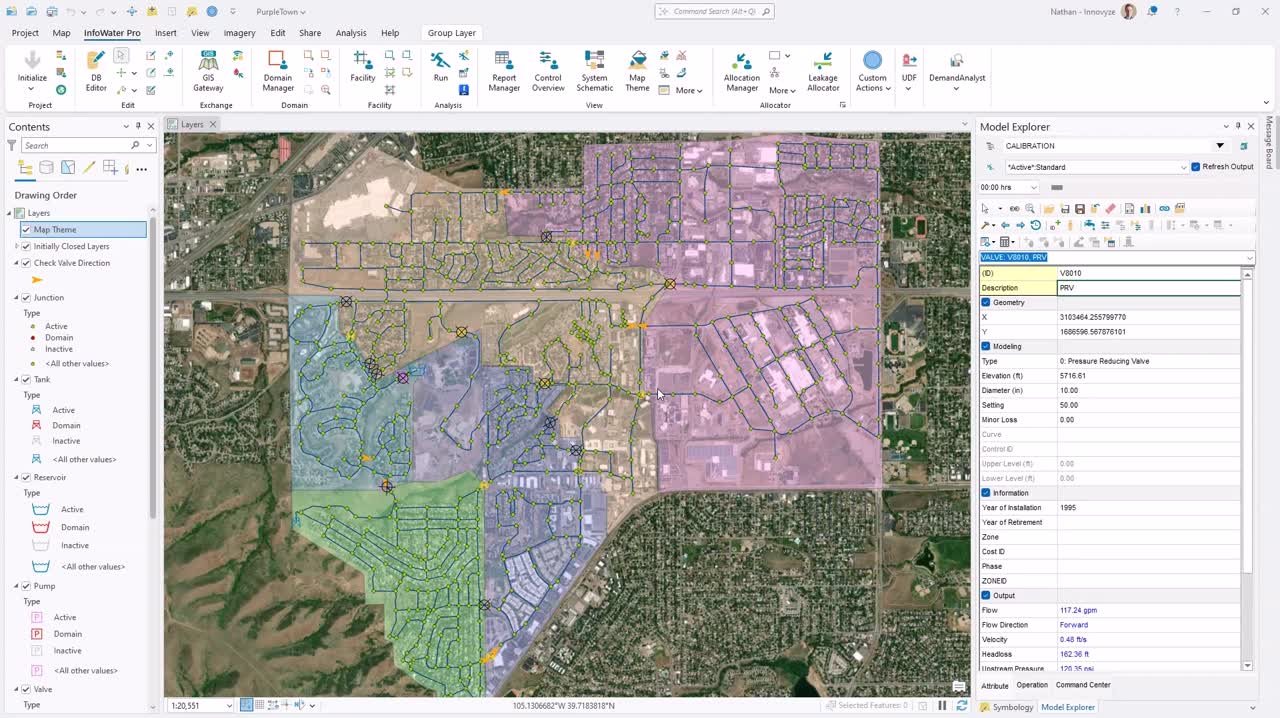

Updated Base Symbology with Dynamic Rotation
We’ve updated the base symbology to support dynamic rotation. New map symbols now rotate dynamically to match feature geometry and flow. This update makes map direction easier to read and improves visual accuracy.
To see the new symbols and their rotation in existing models:
  1. Select Reset to Default (Reset Display) to apply the updated symbology.
  2. To apply the updated symbology, follow these steps:
    1. Open the Preferences dialog and navigate to the Default Symbol tab.
    2. In the Default Symbol tab, select the checkboxes for valve and pump symbols.
    3. Click the Reset to Default button.
    4. Click OK in the Preferences dialog to confirm your changes.
  3. To apply the rotation, go to the View group and select Refresh Map.
Note: Resetting restores the product’s default symbology and removes any custom symbol overrides for the model.
Updated symbology example

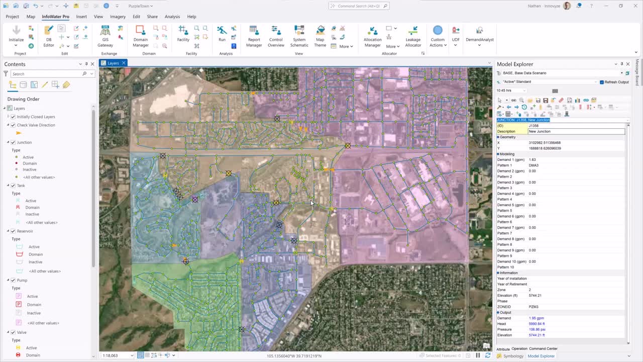

Default symbols
