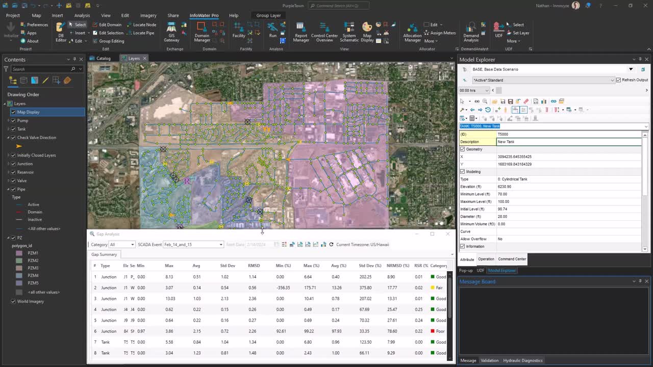

Info360 model results sharing
When running cloud simulations, you can share the full results with Info360 for visualization in web dashboards alongside measured data. This requires the purchase of Info360 Insight. This integration supports sharing of multiple scenarios for comparison and replacing of previous runs, so that modelers can quickly convey results to stakeholders.
