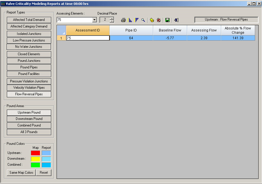

Flow reversal pipes are those pipes whose flow has reversed direction during the assessment. The report shows flow before and after the assessment.
Toolbar
Some toolbar buttons may not be available for all reports. Toolbar items that are grayed are not available for this report type.
Report
Assessment ID - The ID's of the elements assessed during the valve criticality analysis are listed in this column of the table.
Pipe ID - ID of the flow reversal pipe.
Baseline Flow - Flow before the flow reversal.
Assessing Flow - Flow after the flow reversal.
Absolute % Flow Change - Displays the absolute percent change of flow.
Pound Areas
Use this option to select between Upstream Pound, Downstream Pound, Combined Pound or All 3 Pounds.
Pound Colors
Displays the color scheme used for the pound report on the map display.
