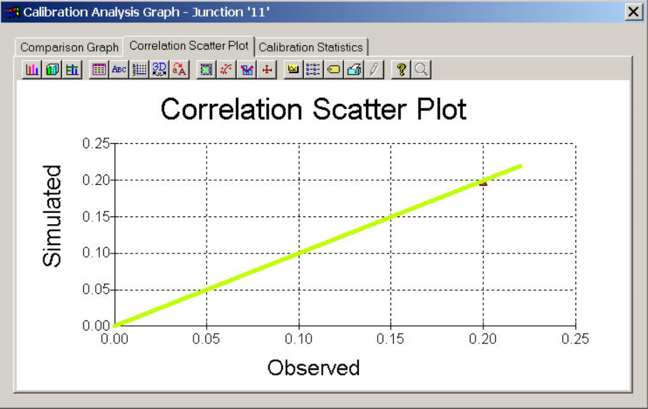

Correlation Scatter Plot
The Correlation Scatter Plot displays a scatter plot of the observed and simulated values for each measurement made of the component in the network. The closer that the points come to the 45-degree angle line on the plot the closer is the match between observed and simulated values.
