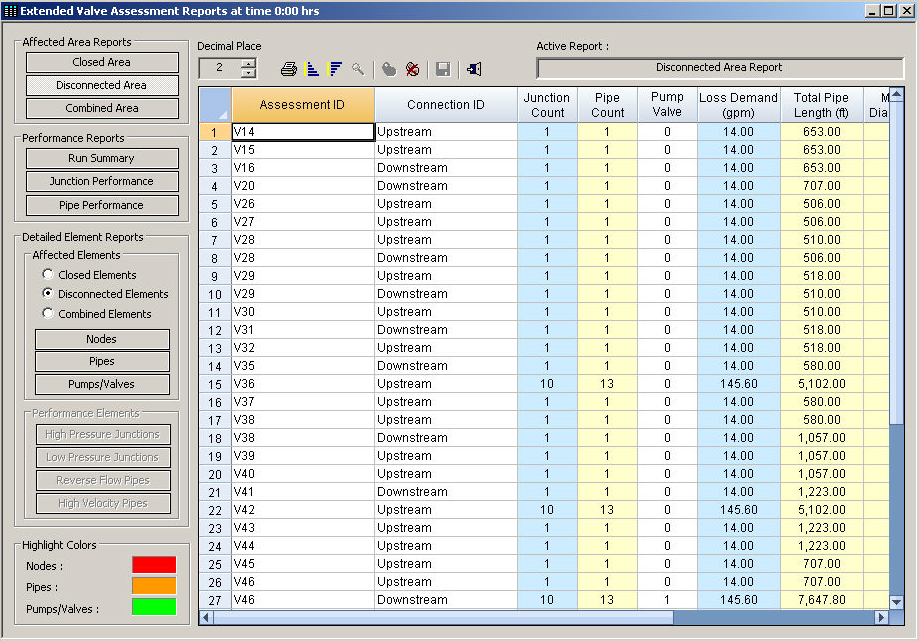

Disconnected Area
Affected Area Reports - Disconnected Area Report
The table for Disconnected Area is empty for a particular assessment valve if its corresponding simulation does not encounter network disconnection.
  • Assessment ID - ID for an individual assessment valve.
  • Connection ID - Displays Upstream or Downstream connection.
  • Junction Count - The total number of affected junctions in Closed Area, Disconnected Area, or Combined Area.
  • Pipe Count - The total number of affected pipes in Closed Area, Disconnected Area, or Combined Area for a given assessment valve.
  • Pump Valve Count - The total number of affected pumps and valves in Closed Area, Disconnected Area, or Combined Area for a given assessment valve.
  • Loss Demand - The total demand loss in Closed Area, Disconnected Area, or Combined Area for a given assessment valve. Units for demand are defined in the Simulation Options.
  • Total Pipe Length - The total pipe length in Closed Area, Disconnected Area, or Combined Area for a given assessment valve. Units for length are defined in the Simulation Options.
  • Min. Pipe Diameter - The minimum pipe diameter in Closed Area, Disconnected Area, or Combined Area for a given assessment valve. Units for diameter are defined in the Simulation Options.
  • Max. Pipe Diameter - The maximum pipe diameter in Closed Area, Disconnected Area, or Combined Area for a given assessment valve. Units for diameter are defined in the Simulation Options.
  • Avg. Pipe Diameter - The average pipe diameter in Closed Area, Disconnected Area, or Combined Area for a given assessment valve. Units for diameter are defined in the Simulation Options.

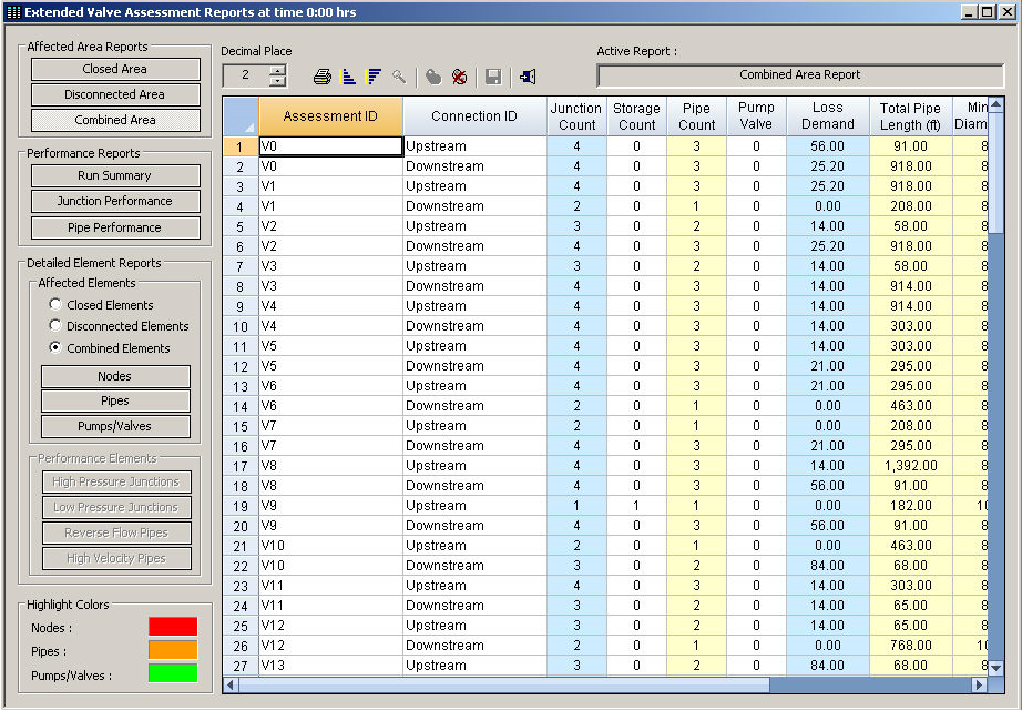

Combined Area
Affected Area Reports - Combined Area Report
Combined Area is the sum of Closed Area and Disconnected Area.
  • Storage Count - The total number of affected tanks and reservoirs in Closed Area, Disconnected Area, or Combined Area for a given assessment valve.
