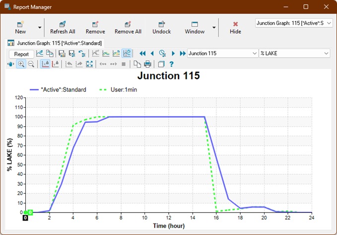

Consider the following trace simulation results for EPANET's Net3 model, one using a quality time step of 60 minutes (blue) and another using a step of 1 minute (green). When using the coarser resolution, there is a considerable delay in the arrival of the water parcels coming from the Lake and the River reservoirs. This is a direct consequence of bulk-mixing parcels together throughout the network.

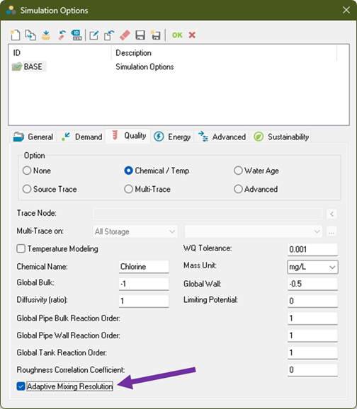

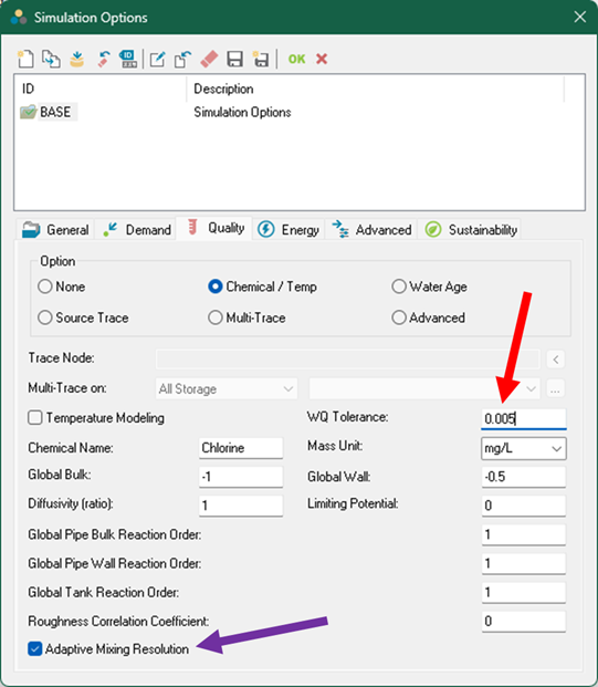

- Activate the adaptive mixing option. The option is found in
Simulation Options > Quality tab.

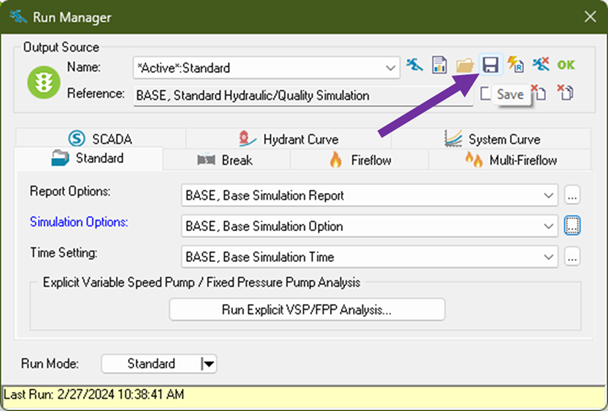

- Save desired results. With the selected quality step, store the simulation results with the option in the Run Manager.

- Activate the adaptive mixing option. The option is found in Simulation Options > Quality tab.
- Increase the quality tolerance. As a starting point, we recommend a value five times as high as the one used normally. This parameter is also found in the same dialog.
Note: The tolerance is in the same units as the quality values, and it should be scaled to match their variation range. As a rule of thumb, it is safe to use a thousandth of the normal variation range of your quality value as the tolerance. For example, simulations with chlorine concentrations between 0 and 2 mg/L can use a tolerance of 0.002; water age ages between 0 and 48 hours could use a value of 0.05; and tracer ranges between 0 and 100 can use a value of 0.1.

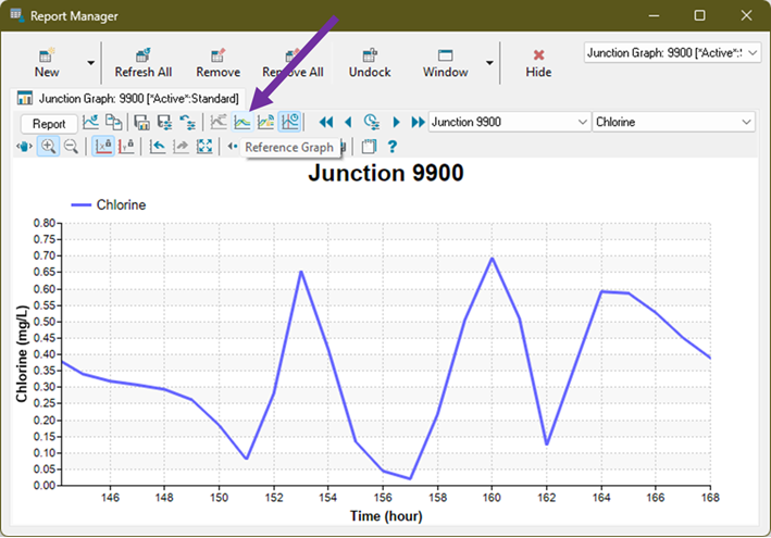

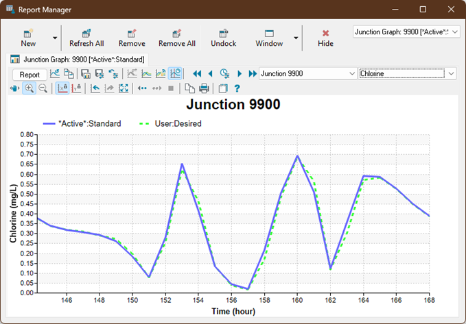

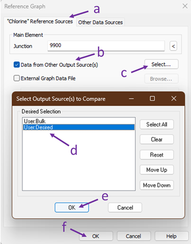

- Compare the results with the desired ones. The desired results should be loaded into the project. To compare time series graphs, for example, first click on the Reference Graph button on the Report Manager graph tab. Then, on the Reference Graph dialog, click on a) "XXXX" Reference Sources, b) Data from Other Output Source(s), c) Select…, d) User:YYYY (saved desired output), e) OK, and f) OK.
- Fine tune tolerance. Further increasing the tolerance will result in faster simulations; decreasing it will result in more accurate ones. Re-adjust the tolerance, re-run the simulation, and refresh the comparisons to further explore the trade-offs between performance and accuracy.
Ideally, this process will result in overall better performance with similar or better results than before. However, adaptive mixing will be more beneficial if there are significant heterogeneities in the model. In the worst-case scenario, using adaptive resolution with the right quality step and tolerance values should not make simulations longer.
