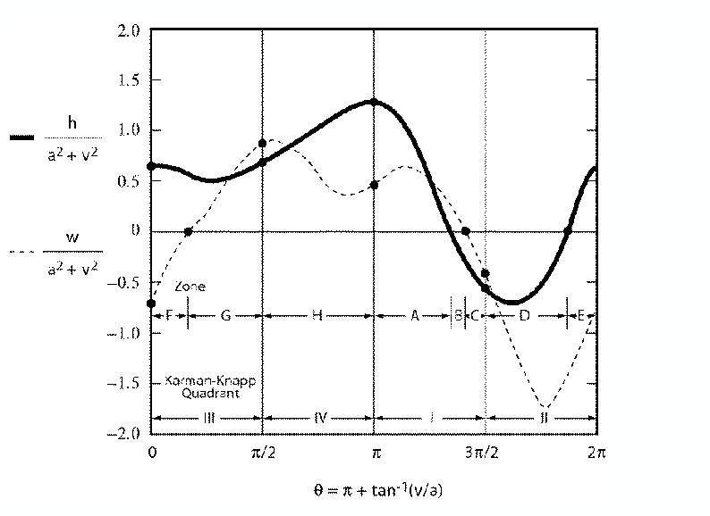

Figure 4 – Complete Head and Torque Characteristics of a Radial-Flow Pump in Suter Diagram

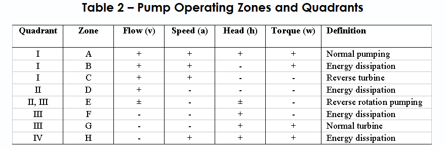

Abnormal Pump (Four Quadrant) Characteristics – InfoSurge utilizes the full four quadrant pump characteristics in addition to using the moment of inertia of the moving pump parts to compute pump rundown speeds. This approach is important for situations where abnormal pump operation occurs such as turbining, flow, and speed reversal. The approach suggested by Suter using data from Hollander’s experiments is utilized (Marchal et al. 1985; Mays 2000). The regions of operation shown on the above plot are termed zones (I through IV) and quadrants (A through H), the latter definition originating from plots of lines of constant head and constant torque on a flow-speed plane. The four quadrant pump characteristic plots depict values of h/(a2 + v2) and w/(a2 + v2) where h = H/HR, w = T/TR, a = N/NR and v = Q/QR. The plots are made utilizing 89 data points at intervals of π/44 radians and the plots shown use a unit of π/44 for the abscissa. A description of the various conditions for each of the eight zones of pump operation is shown in Table 2 below.
Table 2 – Pump Operating Zones and Quadrants

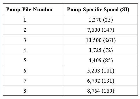

Three files have been constructed using the classic data from the Hollander experiments on centrifugal pumps tabulated in Streeter and Wylie (1983, 1993). An additional five (5) files have been constructed using data provided by Thorley (1991). The appropriate file to be used to simulate a pump is selected based on the specific speed. The specific speed is given by:
where the Reference Flow QR is in gpm (m3/s) and the Reference Head HR is in ft (m). The available files are listed below. The specific speed shown for the files is given in English units with values in parenthesis for SI units. When a standard Pump File is to be utilized, then the specific speed for each pump to be modeled is first calculated and the file selected for the specific speed that is closest to the computed value. Pumps described by a Pump File can be tripped (lose power) and the resulting rundown calculated based on the pump motor inertia and dynamic characteristics described in the Pump File.
