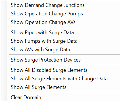

Click the Identify Surge Elements  button from the InfoSurge toolbar to choose an option from the following options in the drop-down menu list to add certain InfoSurge elements to a domain.
Show Demand Change Junctions - This option will add all Junctions that have demand changes setup to the domain.
Show Operation Change Pumps - This option will add all pumps with operation change data setup to the domain.
Show Operation Change AVs - This option will add all Active Values (AV) with operation change data setup to the domain.
Show Pipes with Surge Data  - This option will add all pipes with the wave speed set to the domain.
Show Surge Protection Devices - This option will add all junctions configured as Surge Protection Devices to the domain.
Show All Disabled Surge Elements - This option will add all Surge Elements that are set as disabled to the domain.
Show All Surge Elements with Change Data - This option will add all Surge Elements with change data.
Show All Surge Elements - This option will add all Surge Elements without change data.
Clear Domain - This option will remove all entities in the domain.
