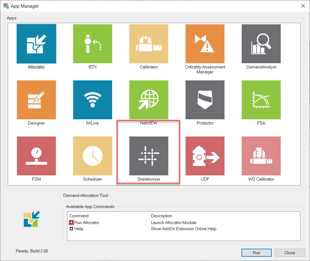

The Skeletonizer main dialog box is accessed from the InfoWater Pro tab. Then click on Apps
toolbar button. Choose Skeletonizer from the App Manager dialog box and click on the Run button.
