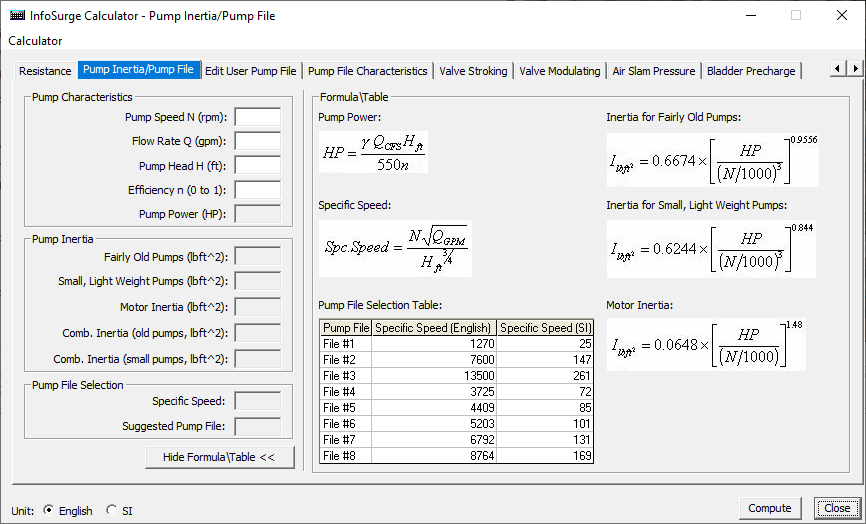

Pump Inertia - This option will help you determine the sum of the pump inertia and the motor inertia. The Pump Inertia Calculator calculates the pump and motor inertia based on the rated conditions using curves fit to a large quantity of data.
Pump Inertia
Fairly Old Pumps - Inertia for pumps manufactured before 1970.
Small, Light Weight Pumps - Inertia for small, light weight pumps.
Motor Inertia - The inertia of the moving parts of the motor.
Comb. Inertia (Old Pumps) - Combined inertia for old pumps.
Comb. Inertia (Small Pumps) - Combined Inertia for small pumps.

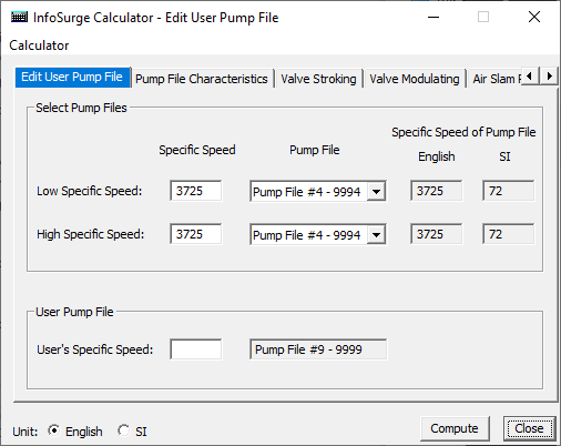

Edit User Pump File - This option will help you customize an intermediate pump file based on the pump's specific speed. The date in the intermediate pump file is interpolated from the two pump files chosen by you.
Select Pump Files
Low Specific Speed - The specific speed of the pump file chosen by you, which is the lower bound of the specific speed range for interpolation.
High Specific Speed - The specific speed of the pump file chosen by by you, which is the upper bound of the specific speed range for interpolation.
User Pump File
User's Specific Speed - The specific speed of a pump specified by you.

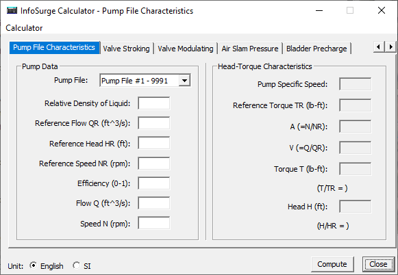

Pump File Characteristics - This option will help you to determine operating conditions for pumps described by a pump file based on the rated conditions and the Flow and Speed at which the pump is operating.
Pump Data
Pump File - Allows the you to determine operating conditions for pumps based on the rated conditions and the flow and speed at which the pump is operating. Select the Pump File to use as determined by the Pump File Selector.
Relative Density of Liquid - Enter the Relative Density of the liquid. Use 1 for water.
Reference Flow QR - Flow rate of the pump that defines the Pump File Characteristics.
Reference Head HR - Head gain that defines the Pump File Characteristics.
Reference Speed NR - Speed of the pump that defines the Pump File Characteristics.
Efficiency (0-1) - The pump efficiency is the pump hydraulic power divided by the electrical power.
Flow (Q) - Unit of flow being used during operation.
Speed (N) - Operating Speed of the pump, rpm.
Head-Torque Characteristics
Pump Specific Speed - Specific speed of the pump.
Reference Torque (TR) - Reference torque of the pump.
A(N/NR) - Dimensionless pump speed.
V (Q/QR) - Dimensionless flow.
Torque (T) - Operating torque of the pump.
Head (H) - Head gain during the operation.

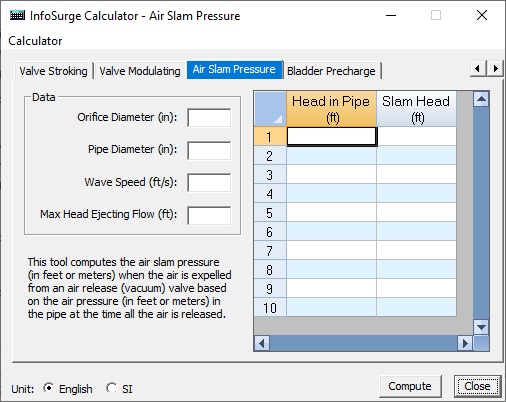

Air Slam Pressure - This option will allow you to estimate the surge pressure potential due to air expulsion from an air release/vacuum release valve. It calculates the pressure surge generated by the water column impact following the expulsion of air from an air release/vacuum release valve. You can provide the required data displayed on the screen and an upper limit for the air pressure just prior to the slam and the tool computes surge pressures for a range of air pressures up to the maximum.
Data
Orifice Diameter - The orifice diameter in the air valve.
Pipe Diameter - The diameter in the pipe.
Wave Speed - This is the speed of the pressure wave propagation in a pipe filled with fluid.
Max. Head Ejecting Flow - The maximum pressure head in the pipe.
Calculate
Head in Pipe - The head in the pipe.
Slam Head - The surge pressure potential due to air expulsion from an air release/vacuum valve.

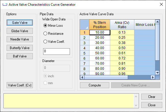

AV Characteristics Curve Generator - This option will allow you to calculate the minor loss (k-coefficient) for a valve based on an input curve of the Open Area Ratio versus the Stem Position. The Active Valve Characteristics Curve Generator can be used to create a curve that describes the Minor Loss vs. Percent Open characteristics of a typical valve. This curve is used to describe the throttle control valve characteristics in the Curve data field of the Attribute Browser. The Throttle Control Valve is used to model an Active Valve in a surge model. After the new AV Characteristic Curve is generated the Create New Curve button will allow you to automatically move the new curve data into the current model's curve data table.
Options
To generate the Active Valve Characteristics Curve, select the valve type or flow coefficient option:
Gate Valve - Select this option for typical gate valve characteristics.
Globe Valve - Select this option for typical globe valve characteristics.
Needle Valve - Select this option for typical needle valve characteristics.
Butterfly Valve - Select this option for typical butterfly valve characteristics.
Ball Valve - Select this option for typical ball valve characteristics.
- Valve Coefficient (Cv) - This option allows you to calculate the minor loss coefficient curve based on the internal diameter of the valve when the percent stem position and the valve coefficient (Cv) are known.
Pipe Data
Wide Open Data
This section of the dialog box allows the user to calculate the Minor Loss coefficient based on a known Minor Loss, Resistance or Valve Coefficient.
Minor Loss - Enter the minor loss (k) of the wide open valve.
Resistance - Enter the Resistance of the wide open valve.
Valve Coefficient - Enter the valve coefficient (Cv) of the wide open valve.
Value - Enter the Minor Loss, Resistance or Valve Coefficient to be used for the curve data calculation.
Diameter
Enter the valve diameter, if required, for the curve data calculation.
Value - Enter the diameter value.
Inch - Select this option for diameter in inches.
mm - Select this option for diameter in millimeters.
Active Valve Curve Data
% Stem Position - This value is defined by the user usually in evenly spaced increments according to available data.
Area (Cv) Ratio - Open area ratio (=open area / full open area)
Minor Loss K - The Minor Loss Coefficient value that corresponds to the valve percent open which is used during the surge analysis.
Compute - This button will compute the headloss coefficient according to assigned loss value.
Create new Curve - This button will export the calculated values to a new curve in the model operation data that can then be assigned to an active valve within the system.
Clear - This button will clear the current input data from the calculator.
Close - This button will close the current dialog box or calculator.
