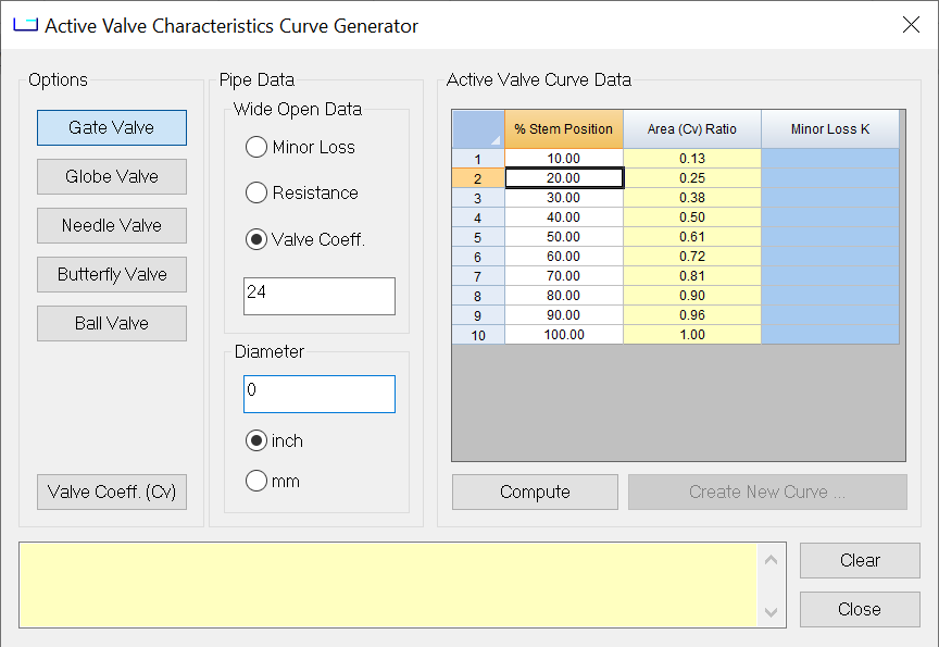

Any valve position (% open) change produces a transient. In order to create a transient using a valve operation, you need to assign two curves. First is the Active Valve Characteristic (AVC) curve, presenting “% stem position” vs. “minor loss K” and the other is the Operational Change Data (OCD) curve, presenting “time” vs. “% stem position”. The AVC curve presents the valve characteristic (e.g., gate valve, global valve). The OCD curve presents its stem position change during the transient analysis. The detail procedure of valve transient in surge analysis is shown as follows:
  1. In order to create the active valve characteristic curve, AV Characteristic Curve Generator (see the following) will help to create the active valve. After assigning your valve characteristic like the second figure, you can click on Create New Curve button to create the curve.

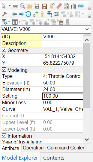

  2. After creating the active valve characteristic curve, it should be assigned in the valve Modeling Data as follows:
  3. Click on the  AV Surge Data  button, and then click Activate to use this valve as an active valve in transient.

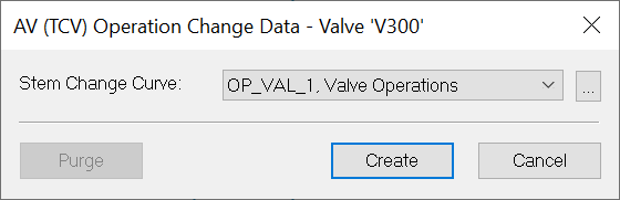

  4. Click on the AV (TCV) Operation Change button to create and assign stem change curve.
