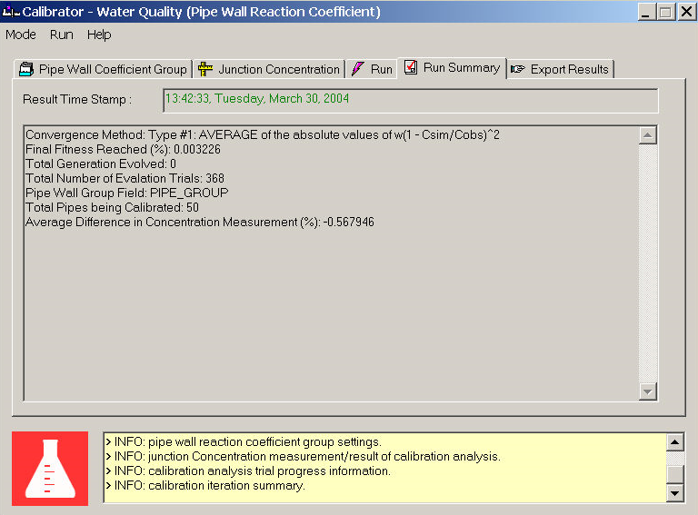

WQ Run Summary
The following dialog box appears for the Run Summary tab when the WQ Calibration analysis is completed. The WQ Calibrator creates the ASCII calibration summary report in the Run Summary tab window.
