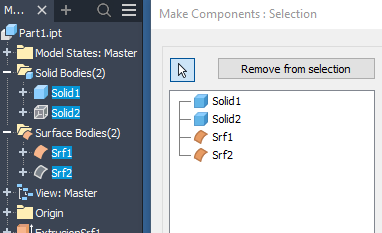

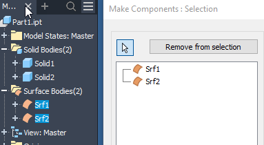

Select surface bodies during Make Components operation
When using the "Make Components" command it is now possible to select surface bodies. Surface bodies can be selected from the browser or the graphics window.
Select non-visible bodies during Make Components operation
When using the "Make Components" command you can now also select the invisible bodies.

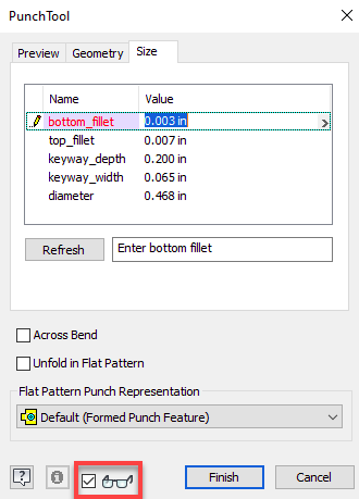

Punch tool preview improvements
You can now control if preview is computed or not using the new Preview control added to the Punch tool dialog. Preview updates when you deselect points, or change values, for example
Also, the Punch tool performance is much improved using an optimized compute method.
