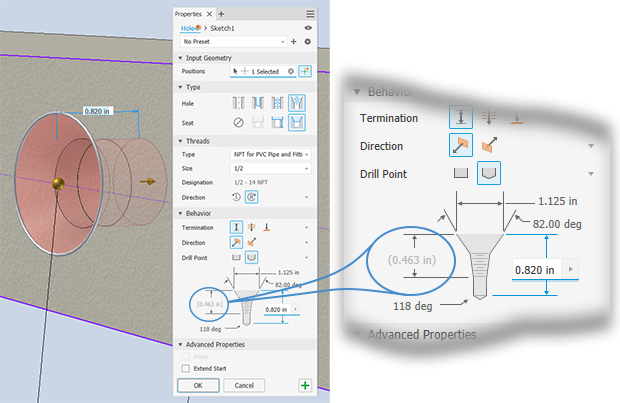

Property Panel Enhancements
Highlight New badges are provided for Ribbon Commands and Property Panel features. The badges help you quickly identify new or updated commands and feature options. Badges also display for feature options not readily visible. You control whether or not they go hide after first use or remain visible.
For more about Highlight New badges, see To Work with New and Updated Badges.
Improved highlights of input fields and in-panel notifications to enhance clarity.

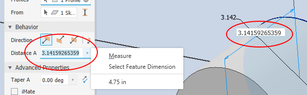

Value edit fields, during an edit operation, expand to show the full value entered.
Reference Dimensions are displayed similar to Driven Dimensions and in gray to differentiate them from normal dimensions.
For more information about property panels see About Property Panel and To Work with Presets.

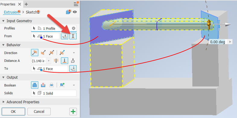

Extrude Between
The

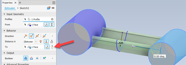

Between option is added to the Extrude command. The option, when checked, expedites the creation process by focusing on selecting the From/To faces.
Additionally, commands requiring more than one face to be selected, such as Extrude Between, display different colors for each selection making it easier to distinguish the input geometry.
When multiple solutions are possible, toggle the Alternate Solution option to cycle through the possibilities.
