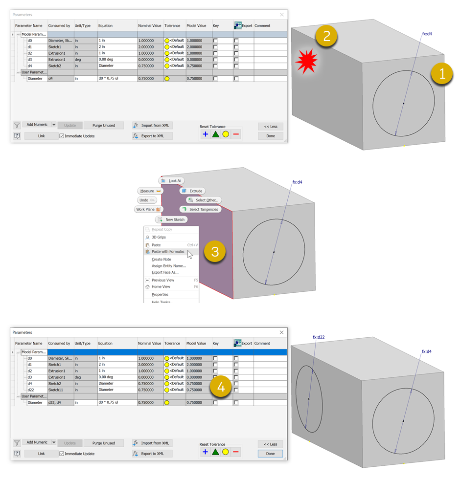

Paste with Formulas
When pasting a copied sketch, the right-click menu now has an option to Paste with formulas. User defined parameters are included in the paste action. Parameters associated with the source sketch are copied and pasted without being duplicated. Paste with Formulas is supported only within the same document, not across documents.

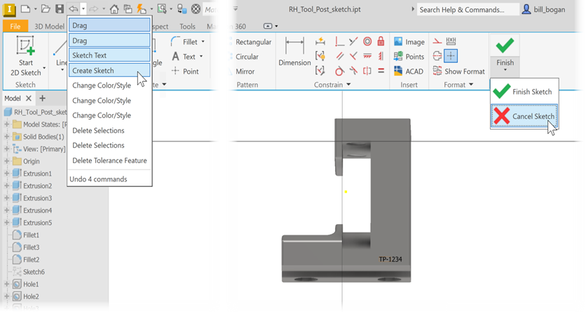

Cancel Sketch
This enhancement affects all 2D and 3D sketch workflows regardless of the document type. For drawings, this includes title blocks, view sketches, sheet sketches, symbol sketches, and borders. For parts, sketch blocks are included.
Upon starting or editing a sketch, the command Cancel Sketch populates the ribbon with the Finish Sketch command.
Cancel Sketch is the equivalent to undoing all actions back to the creation or current editing of the sketch. The Undo/Redo lists populate with the actions.

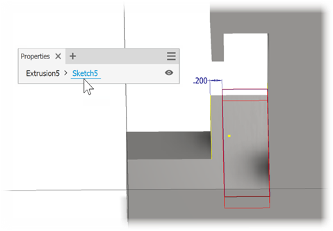

If editing the sketch via the feature breadcrumb, the feature edit is terminated by canceling the sketch.
