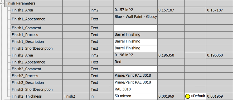

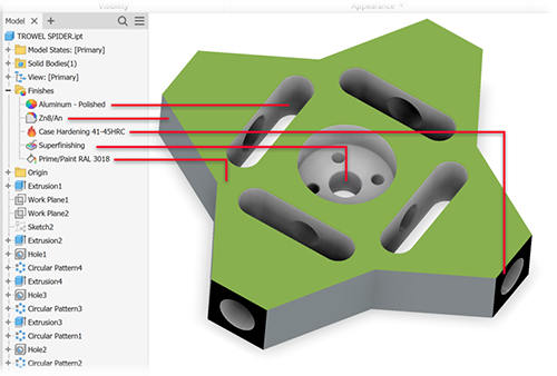

  • Finish
    The new Finish feature enables you to not only specify the appearance of your parts, components and assemblies, but also the manufacturing process such as material coating or surface finish.
    All applied finishes are listed in a new Finishes folder in the browser. You can re-order the finishes in the browser node, suppress, rename or delete them.
    In Drawings, a new "Parameters - Finish" type category is added to the Leader Text and the Format Text dialogs to enable Finish information to be used in drawing notes. These parameters will automatically be updated if changed in the modelling environment. This enhances your drawing by adding additional manufacturing process information to the documentation.
    Each Finish feature setting has a parameter with corresponding unique name in the "Finish Parameters" category in the Parameters dialog. All Finish parameters can be exported. Exported parameters are displayed in iProperties. Note that change in iProperties doesn't affect the model finish feature parameters.
    For more information see To Assign a Finish to a Component.

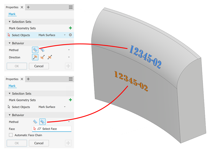

  • Mark
    • Use non-coplanar sketches to define the mark sketch geometry.
    • Wrap or project the sketch to a non-planar face.
      Use the Project option for complex faces and the wrap option for simple curved faces.
      For more information see To Mark Faces.

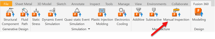

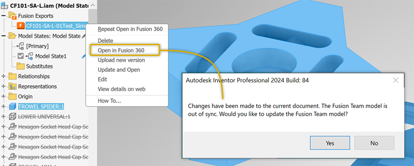

  • Inventor Fusion Interoperability
    From within Inventor you can send a part (.ipt) file to Fusion 360 and create Manual Inspection tasks.
    For more information see To Connect to Fusion 360 Workspaces.
  • Fusion Exports Workflow
    If a change has occurred in the Inventor model state or design view used for a Fusion 360 export, and you click Open in Fusion 360 in the export context menu, you are notified that the Inventor model and Fusion 360 model are out of sync and are given the option to update the Fusion 360 model before opening it.

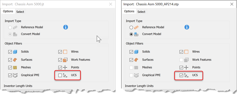

    • UCS Support
      Both JT and STEP support the option to include UCS on import.
      Note: UCS import is available for STEP files exported without PMI.
      For more information see To Import Files as an AnyCAD Reference or Convert Model.

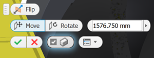

    You can now select a revolved face, cylindrical or conical, to define the direction for a component pattern. The Pattern Component command uses the face axis to define the pattern direction. Use the standard controls to flip the direction.
    It is not necessary to activate the selector when using an origin axis, clicking the flyout activates the selector and chooses the selected axis. The direction selection does not change with the activation of the selector, you must also select a new direction.
    For more information see Create rectangular patterns of components

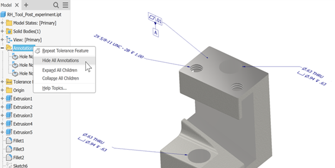

    • Annotation Folder
      All 3D annotations are placed in a folder in the model browser. All 3D annotations can be hidden by Hide All Annotationsin the folder context menu.

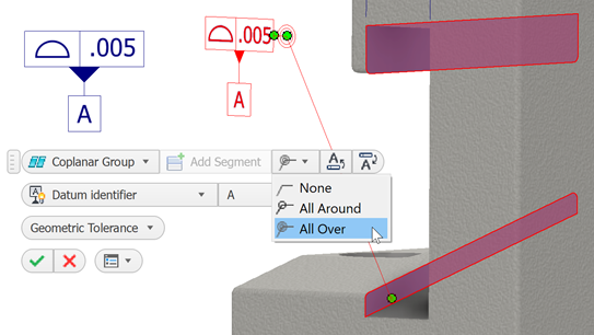

    • All Over Modifier
      The All Over modifier is now available for feature control annotations.

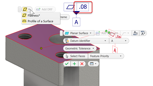

    • Flatness and Profile of a Surface
      These tolerance options now have default values when applied to the model.

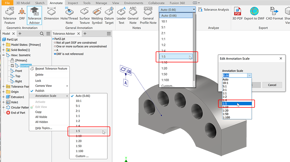

    • Annotation Scale
      In this release, 1:5 scale is added to the annotation scale drop down per DIN EN ISO 55455

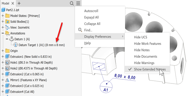

    • Datum Target Browser Node
      The Datum Target browser node now displays the target size when using the extended name option.

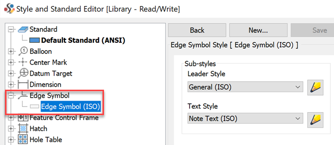

  • Edge Symbol
    Starting from this release of Inventor, you can define an Edge Symbol based on ISO 13715:2019 standard. The new Edge Symbol command is added to the Symbols panel of the Annotate tab.
    The Edge symbol style is added to the drawing Style and Standard Editor.
    For more information see Add an edge symbol.

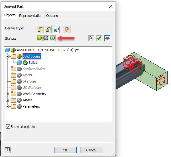

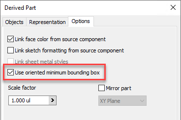

  • Oriented Minimum Bounding Box
    • You can derive a solid body as an oriented minimum bounding box. A new "Oriented minimum bounding box" option is added to the Options tab of the Derived Part, Derive Assembly and Make Part dialogs. By default, the option is checked. Uncheck the box to derive a body as the orthogonal bounding box.
      Also, representing the selected component in the derived part as the orthogonal bounding box is now available for parts. The option is added to the Derived Part and Make Part dialogs and you can set only one body or the whole Solid Bodies folder.
      For more information see To Create a Derived Part or Assembly.
    • You can cancel the preview of the oriented minimum bounding box when deriving a part, assembly, and when simplifying an assembly.
      For more information see About Derived Parts and Assemblies.

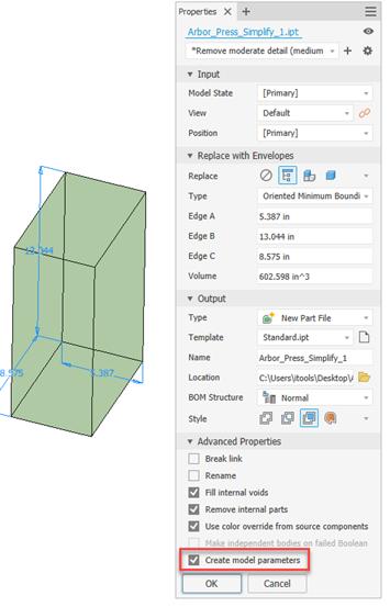

    • Bounding Box Parameters
      When simplifying an assembly and replacing components with envelopes, you can choose the oriented minimum bounding box option. When "Replace with Envelopes" is set to "All in One Envelope", the "Edge A", "Edge B", and "Edge C" values can be set in the property panel and the graphics window.
      A new "Create model parameters" option is added to Advanced Properties of the property panel. When selected, three read only parameters for the "Edge A", "Edge B", and "Edge C" are created in the simplified file.
      For more information see Create a Simplified Part from an Assembly.

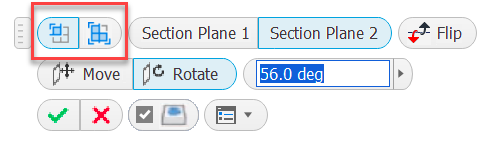

Assembly Section Views
  • Section view definition persists in the design view representation. With this release you can easily edit the section view definition or suppress the section view by right-clicking the view representation node and clicking Section View Edit
    For more information see To Work with Section Views.
  • Large Assembly Performance
    Control Section View end cap preview during section view plane dragging.
    End cap visibility is set by default to display end caps for sectioned geometry when the part count is less than or equal to 500. If the part count is greater than 500 the end caps will not display. You can override the setting by selecting or deselecting the option in the mini-toolbar.
  • Part Section Views
    Section view definition persists in the design view representation. With this release you can easily edit the section view definition or suppress the section view by right-clicking the view representation node and clicking Section View Edit or Suppress.
    Previously, you could only access section views using the context menu commands which required unnecessary clicks. Now, the section view commands and options are added directly to the mini-toolbar in the graphics window.

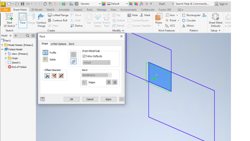

  • Sheet Metal Improved Profile Detection
    When specifying face in Sheet Metal, closed loop detection is now improved to make it easier to select geometry from a sketch, especially in situations where multiple profiles are overlapping.

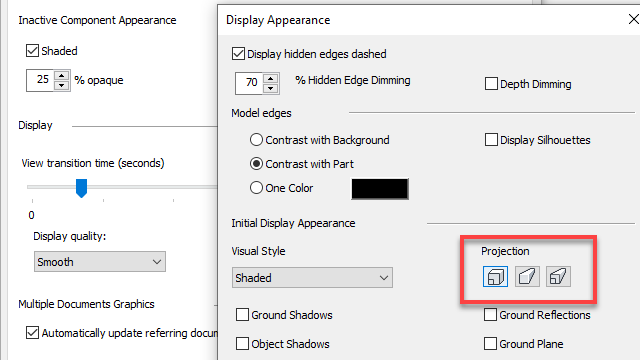

  • Perspective with Ortho Faces
    It is now possible to set Perspective With Ortho Faces as the default view setting in both Document Settings and Application options.
    To access it, go to:
    • Application Options Display tab Appearance Settings Display Appearance dialog Initial Display Appearance Projection
    • Open a modeling document: Document Settings Standard tab Display Appearance Settings Initial Display Appearance Projection

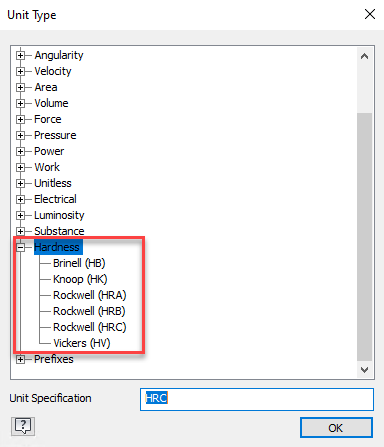

  • Model Parameter Enhancements
    • Hardness
      Hardness is a brand new unit type added for this Inventor release. This allows hardness to be specified in the Finish command, but can also be used on it's own. The following types are available in the Parameters dialog:
      • Brinell (HB)
      • Knoop (HK)
      • Rockwell (HRA)
      • Rockwell (HRB)
      • Rockwell (HRC)
      • Vickers (HV)

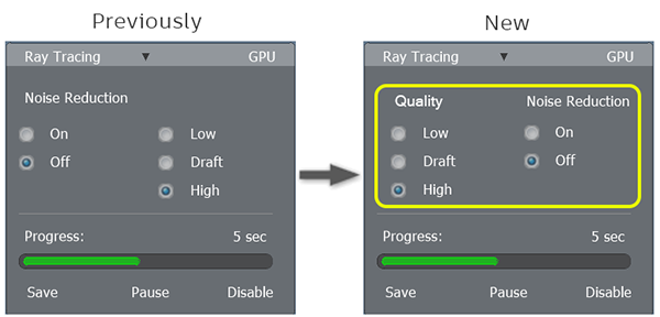

      • Ray Tracing Dialog
        The Ray Tracing dialog has been improved to clarify the purpose for the options that are presented.

  • Shortcut Improvement
    The "J" key is now assigned as the shortcut key to start the Place Joint command in assemblies, weldments, and dynamic simulation.
