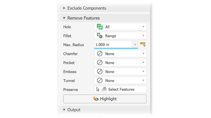

Simplify: Feature Recognition Changes
Markdown card metadata
There is a change in the way features are recognized for the Simplify command. The adjustment provides clearer delineation to additive versus subtractive features.
  • Pocket: recognizes subtractive features - extrudes, revolves, sweeps, and so on.
  • Emboss recognizes additive or positive protrusions.
For more information, see Create a Simplified Part from an Assembly.
