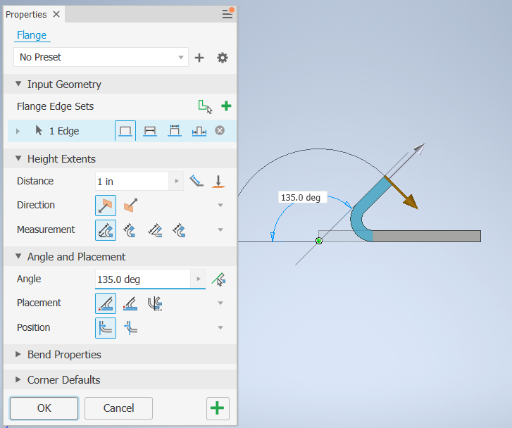

New FlangeFeatures.CreateDefinition method and hide CreateFlangeDefinition method according to the flange feature creation function enhancement. There are 18 members of FlangeDefinition are set to be hidden, and 6 new members are added to it. Also the Edge property for CenteredWidthExtent, EdgeWidthExtent, FromToWidthExtent, OffsetWidthExtent and WidthOffsetWidthExtent is set to be hidden and the new FlangeEdgeSet object can be used to get and set the flange extent info.

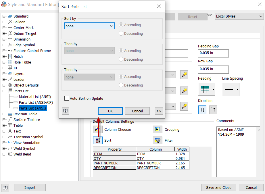

New PartsListSortSettings object can be used to set the partslist sort settings for PartsListStyle.

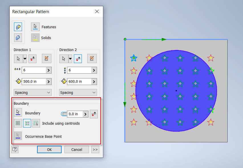

New PatternBoundarySetting object for CircularPatternFeatureDefinition/RectangularPatternFeatureDefinition.BoundarySetting property can be used to get and set the pattern boundary settings. The new CircularPatternFeatureDefinition/RectangularPatternFeatureDefinition.HasBoundarySettingConfigured property can be used to clear the pattern boundary settings.

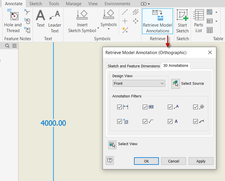

New Sheet.GetRetrievableAnnotations and RetrieveAnnotations methods allow to retrieve 3D annotations and sketch and feature dimensions. New Sheet.GetAvailableDesignViewsToRetrieve3DAnnotations allows to get the design view representations for retrieve 3D annotations. Hide the GeneralDimensions.GetRetrievableDimensions and Retrieve methods. New Retrieved and RetrievedFrom properties for BendNote, ChamferNote, GeneralNote, LeaderNote and PunchNote.

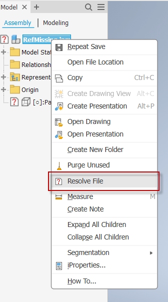

New Document.HasReferencesMissing and ResolveFile members allow to check if a document has references missing or not and trigger the resolve file command.

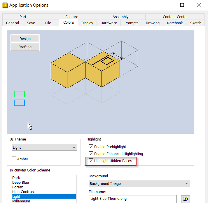

New ColorSchemes.HighlightHiddenFaces property allows to get and set the Highlight Hidden Faces in Application Options.

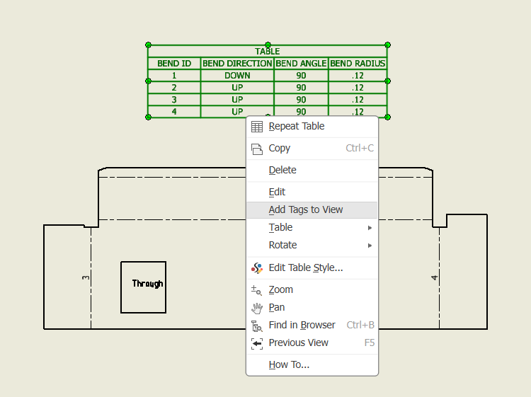

New CustomTable.AddBendTagsToView method allows to add bend tags to view when the CustomTable is a bend table.

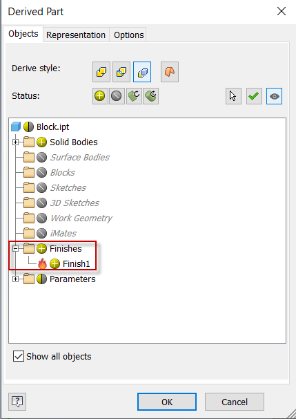

New DerivedPartDefinition.Finishes property allows to get and set the inclusion status for FinishFeature objects in the derived part.

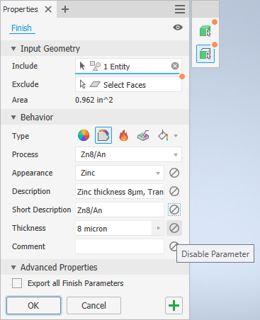

New FinishDefinition.DisableProperties and IsPropertyDisabled methods allow to get and set the disabled status to finish properties.

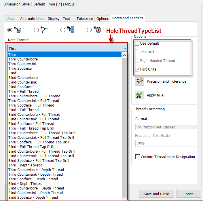

New DimensionStyle.GetHoleThreadNoteOptionValue and SetHoleThreadNoteOptionValue allows to get and set the hole thread note option values. New DimensionStyle.HoleThreadTypeList returns the hole thread type list which can be used for getting and setting the option values.

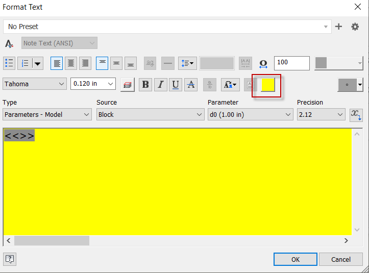

New DimensionText.BackgroundColor and UseBackgroundColor allow to set the background color for dimension text.

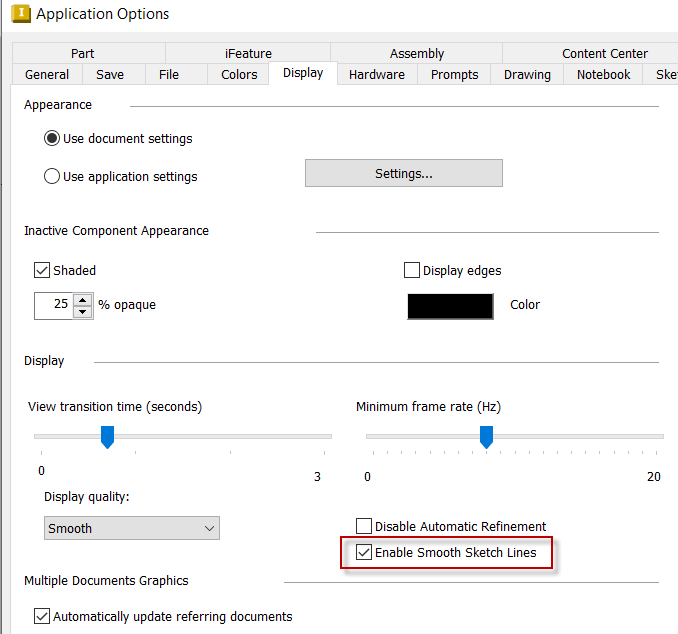

New DisplayOptions.EnableSmoothSketchLines allows to get and set the enable smooth sketch lines option.

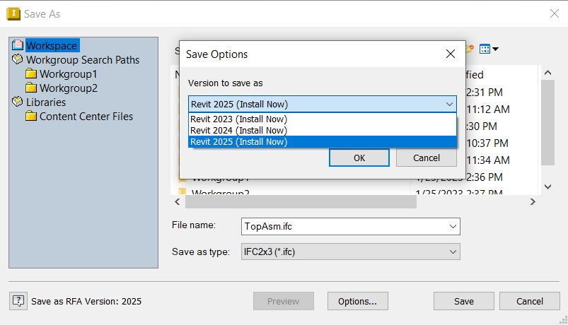

New FileManager.GetRevitEngineInstallationStatus and InstallRevitEngineVersion methods allow to install and check Revit engines in different versions, new RevitExportDefinition.RevitVersion property allows to set the Revit version when export to Revit format.

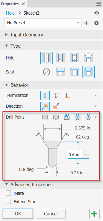

New HoleFeature.DrillPointType property that supports more drill point types. And there are new HoleFeatures.Addxxx2 and HoleFeature.Setxxx2 methods exposed and hide the legacy methods to support new drill point types.

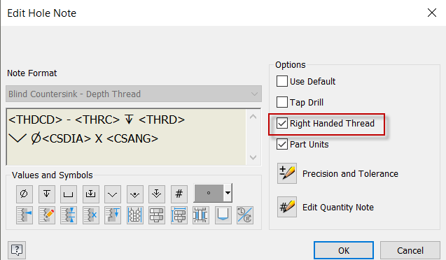

New HoleThreadNote/ModelHoleThreadNoteDefinition.RightHandedThread property allows to get and set the right handed thread option.

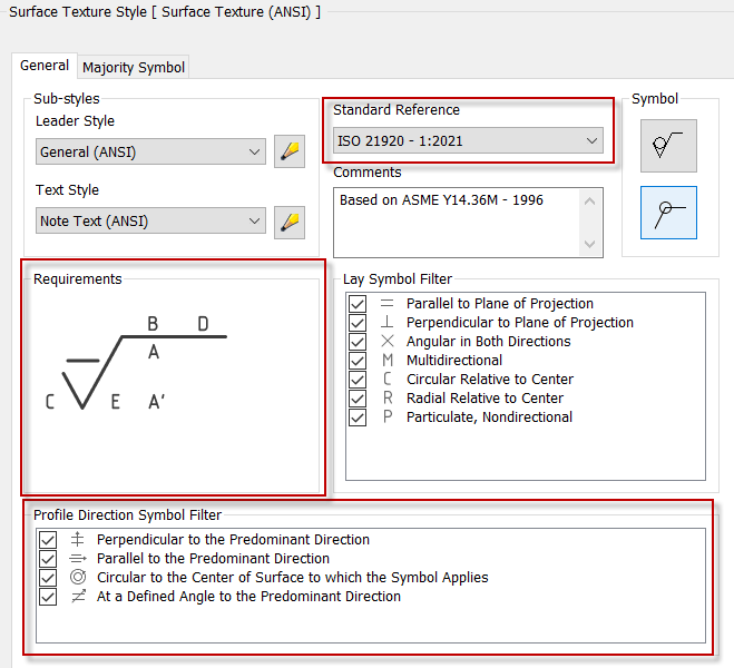

New properties for SurfaceTextureStyle, ModelSurfaceTextureSymbolDefinition and surface texture definitions to support new "ISO 21920 - 1:2021" standard reference.

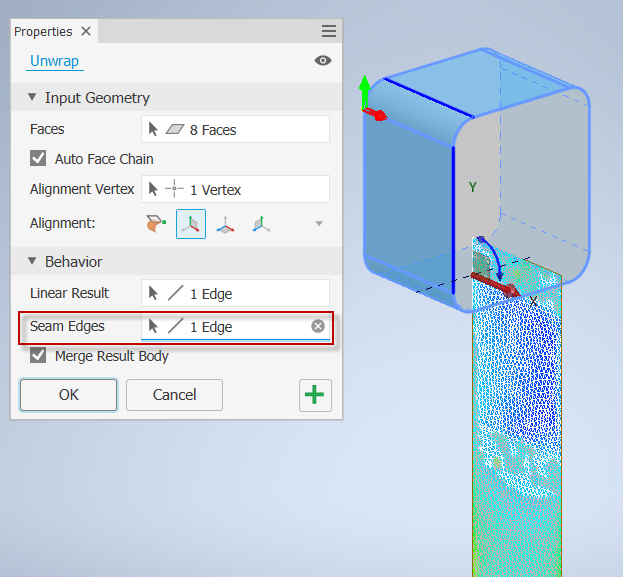

New UnwrapDefinition.SeamEdges and UnwrapFeatures.CreateDefinitionWithOptions to support new seam edges for unwrap feature creation.

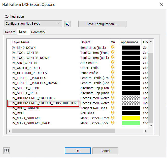

Support new UnconsumedSketchConstructionLayer layer setting when export to DXF format via DataIO.

Add two new kThreadDirectionHoleProperty and kDrillPointHoleProperty enum values for adding hole table columns.

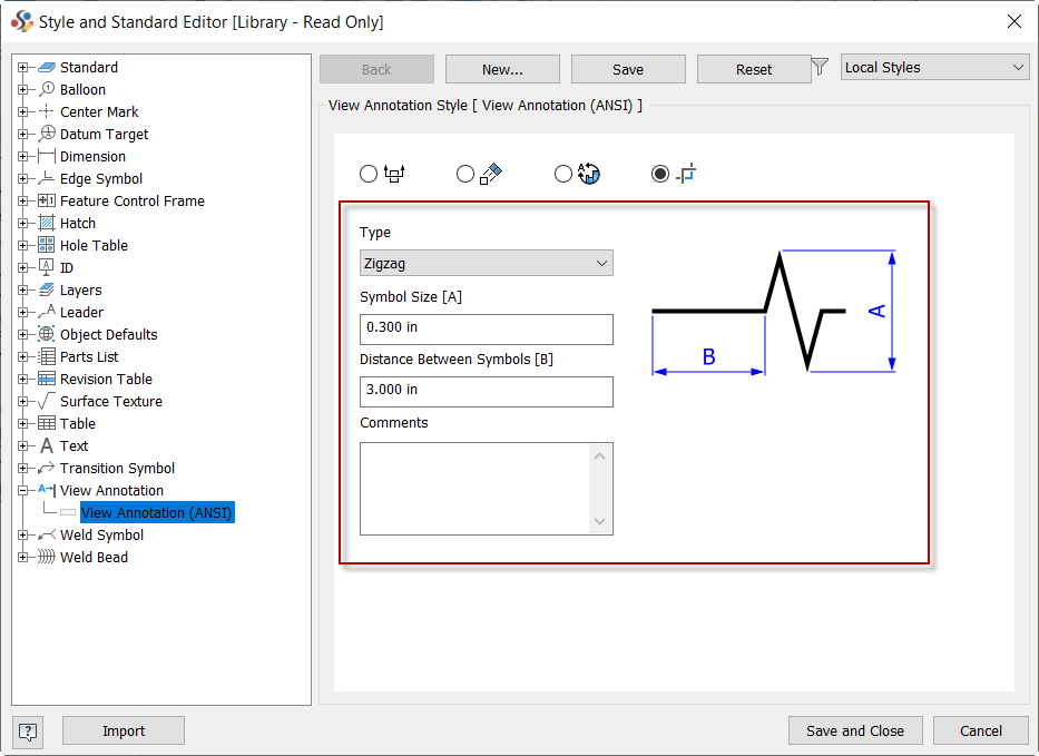

New CropOperation objects allow to create crop on a drawing view, and new ViewAnnotationStyle and CropViewAnnotationStyleSettings allow to specify the crop view annotation style settings.

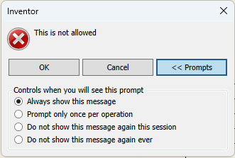

New PromptsOptions and PromptMessage objects allow to access the built-in prompts and create custom prompts.

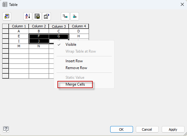

New MergeCell method allows to merge cells in a custom table, and the MergedCell objects allow to access the merged cells and unmerge them.

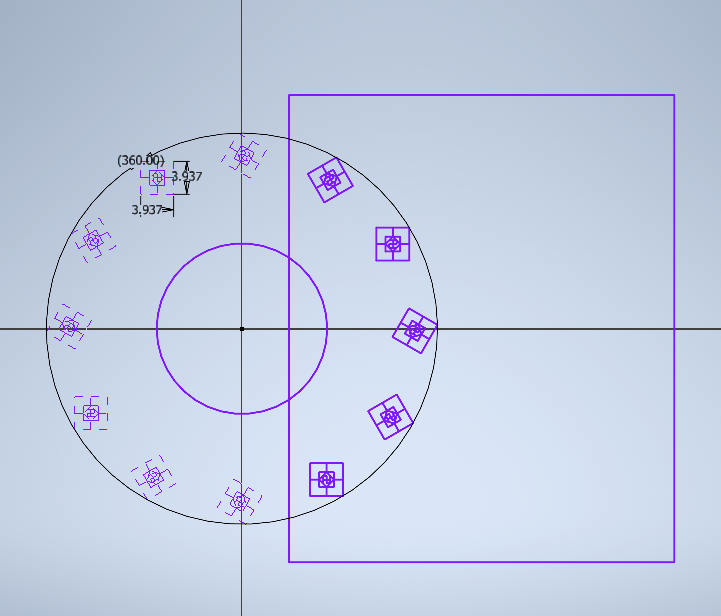

New SketchCircularPattern and SketchRectangularPattern objects allow to create and edit the sketch circular and rectangular patterns.

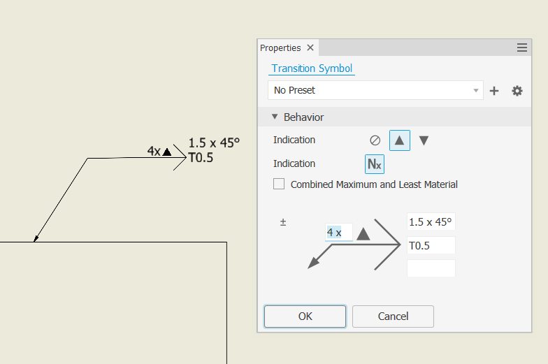

New TransitionSymbol objects allow to create and edit the transition symbols in drawing. New TransitionSymbolStyle allows to access the style for transition symbol.

New FinishDefinition.IncludedEntities and ExcludedEntities properties to replace the FinishDefinition.InputFaces property.

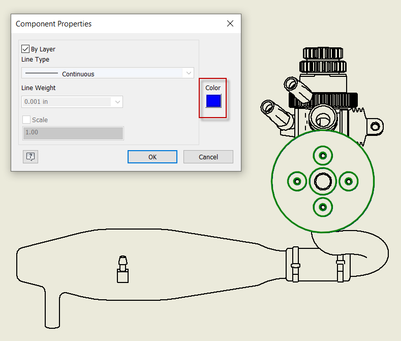

New DrawingView.GetComponentLineColor and SetComponentLineColor methods allow to query and edit the drawing curve line color for a component in drawing.

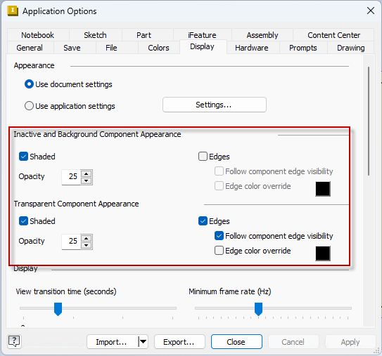

New options for DisplayOptions to control inactive and transparent component edges color.

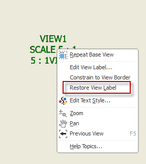

New DrawingViewLabel.RestoreViewLabel method allows to restore the drawing view label to default position.

| FlangeEdgeSet | Flange edge set Object. |

| PartsListSortSettings | PartsListSortSetting Object. |

| PromptMessage | PromptMessage object. |
| PromptMessages | PromptMessages object. |
| PromptsOptions | PromptsOptions object. |

| SketchCircularPattern | SketchCircularPattern Object. |
| SketchCircularPatternDefinition | SketchCircularPatternDefinition Object. |
| SketchCircularPatterns | SketchCircularPatterns Collection Object. |
| SketchPatternElement | SketchPatternElement Object. |
| SketchPatternElements | SketchPatternElements Collection Object. |
| SketchRectangularPattern | SketchRectangularPattern Object. |
| SketchRectangularPatternDefinition | SketchRectangularPatternDefinition Object. |
| SketchRectangularPatterns | SketchRectangularPatterns Collection Object. |
| TransitionSymbol | TransitionSymbol Object. |
| TransitionSymbolDefinition | TransitionSymbolDefinition Object. |
| TransitionSymbols | TransitionSymbols Object. |

| ViewAnnotationStyle | ViewAnnotationStyle object. |
| ViewAnnotationStylesEnumerator | ViewAnnotationStylesEnumerator object. |

| AssemblyDocument.HasReferencesMissing | Read-only property that returns whether there are references missing for this document. |
| AssemblyDocument.ResolveFile | Method that invoke the resolve file for the document if there are references missing. |
| BendNote.Retrieved | Indicates whether the drawing note was created as a result of retrieving it from the model. |
| BendNote.RetrievedFrom | Returns the model annotation this drawing note was retrieved from. |

| CircularPatternFeatureDefinition.BoundarySetting | Read-write property that gets and sets the PatternBoundarySetting object. |
| CircularPatternFeatureDefinition.HasBoundarySettingConfigured | Read-write property that gets and sets whether this pattern has boundary setting configured or not. When set this property it can only be set from True to False to clear the boundary setting. |

| ColorSchemes.HighlightHiddenFaces | Gets and sets whether enables or disables hidden faces highlighting. |

| CustomTable.AddBendTagsToView | Method that adds bend tags to drawing view. |
| CustomTable.MergeCells | Merges the table cells. |
| CustomTable.MergedCells | Returns all MergedCell objects in a table. |
| DerivedPartCoordinateSystemDef.Finishes | Gets the collection of FinishFeatures available in the selected part along with the inclusion option for each FinishFeature. |

| DerivedPartDefinition.Finishes | Gets the collection of FinishFeatures available in the selected part along with the inclusion option for each FinishFeature. |
| DerivedPartDefinition.LinkSheetMetalStyles | Read-write Boolean property that specifies whether to link sheet metal styles or not. This is applicable only when derive another sheet metal document to current sheet metal document. |
| DerivedPartTransformDef.Finishes | Gets the collection of FinishFeatures available in the selected part along with the inclusion option for each FinishFeature. |
| DerivedPartTransformDef.LinkSheetMetalStyles | Read-write Boolean property that specifies whether to link sheet metal styles or not. This is applicable only when derive another sheet metal document to current sheet metal document. |
| DerivedPartUniformScaleDef.Finishes | Gets the collection of FinishFeatures available in the selected part along with the inclusion option for each FinishFeature. |
| DerivedPartUniformScaleDef.LinkSheetMetalStyles | Read-write Boolean property that specifies whether to link sheet metal styles or not. This is applicable only when derive another sheet metal document to current sheet metal document. |
| DetailDrawingView.CropOperations | Read-only property that returns the CropOperations object containing information about all the crop operations applied to this view as well as methods to add crops. |
| DetailDrawingView.GetComponentLineColor | Method that gets color of a component in drawing view. |
| DetailDrawingView.SetComponentLineColor | Method that sets color for a component in the drawing view. |

| DimensionStyle.GetHoleThreadNoteOptionValue | Gets the option value for hole thread notes. |
| DimensionStyle.HoleThreadTypeList | Returns the hole and thread type list. |
| DimensionStyle.SetHoleThreadNoteOptionValue | Sets the option value for hole thread notes. |
| DimensionText.BackgroundColor | Gets and sets the BackgroundColor associated with the DimensionText. |
| DimensionText.UseBackgroundColor | Gets and sets the UseBackgroundColor associated with the DimensionText. |
| DisplayOptions.EnableSmoothSketchLines | Gets/sets whether to use the smooth sketch line. |
| DisplayOptions.InactiveComponentsEdgeDisplayFollowVisibility | Read-write property that specifies whether inactive component edges display should follow the visibility setting of visual styles. |
| DisplayOptions.TransparentComponentsEdgeColor | Read-write property that gets and sets the color for the edge display (including silhouettes) for transparent components. |
| DisplayOptions.TransparentComponentsEdgeDisplay | Read-write property that specifies whether edges should be displayed for transparent components. |
| DisplayOptions.TransparentComponentsEdgeDisplayFollowVisibility | Read-write property that specifies whether transparent component edges display should follow the visibility setting of visual styles. |
| DisplayOptions.TransparentComponentsShaded | Read-write property that enables or disables contrasting shading for the display of transparent components. |
| DisplayOptions.TransparentComponentsShadeOpacity | Read-write property that gets and sets the opacity level (expressed as a percentage) for the shading of transparent components. |
| DrawingDocument.HasReferencesMissing | Read-only property that returns whether there are references missing for this document. |
| DrawingDocument.ResolveFile | Method that invoke the resolve file for the document if there are references missing. |

| DrawingStylesManager.TransitionSymbolStyles | Read-only property that returns the TransitionSymbolStylesEnumerator object. |
| DrawingStylesManager.ViewAnnotationStyles | Read-only property that returns the ViewAnnotationStylesEnumerator object. |
| DrawingViewLabel.RestoreViewLabel | Method that restores the drawing view label to default position. |

| FileManager.GetRevitEngineInstallationStatus | Method that returns the Revit engine installation status for available versions. |
| FileManager.GetTemplateFileWithOptions | Method that gets a template file that can be used to create a new document. |
| FileManager.InstallRevitEngineVersion | Method that tries to install specified Revit engine and returns the installation status. The installation is asynchronous, and this returns kInstallationInProcessStatus if the installation is started. |
| FinishDefinition.DisableProperties | Method that disables or enables the properties in this finish definition. |
| FinishDefinition.ExcludedEntities | Read-write property that gets and sets the Face objects and their proxies that will be excluded from the finish feature. Valid objects in the ObjectCollection can be Face objects and the proxies. |
| FinishDefinition.IncludedEntities | Read-write property that gets and sets the Face and SurfaceBody objects and their proxies on which the finish feature is created. Valid objects in the ObjectCollection can be Face, SurfaceBody and the proxies, or FaceCollection that contains Face or FaceProxy. |
| FinishDefinition.IsPropertyDisabled | Method that returns whether the specified property is disabled or not. |
| FinishFeatures.CreateDefinition | Method that creates a new FinishDefinition object. The object created does not represent a finish feature but instead is a representation of the information that defines a finish feature. You can use this object as input to the FinishFeatures.Add method to cre. |
| FlangeDefinition.AddFlangeEdgeSet | Method that adds a new flange edge set. |
| FlangeDefinition.EdgeSetCount | Read-only property that returns the flange edge set count currently defined in this flange definition. |
| FlangeDefinition.EdgeSetItem | Method that returns the specified FlangeEdgeSet object from the collection. |
| FlangeDefinition.FlangeAngleReferenceType | Read-write property that gets and sets the flange angle reference type. When change this from flange angle value type to reference plane type the SetFlangeAngleReferenceType should be used. |
| FlangeDefinition.FlangePlacementType | Read-write property that gets and sets the flange placement type. |
| FlangeDefinition.SetFlangeAngleReferenceType | Method that removes the override width extent for the specified physical flange. |
| FlangeFeatures.CreateDefinition | Method that creates a new FlangeDefinition object. The object created does not represent a flange feature but instead is a representation of the information that defines a flange feature. You can use this object as input to the FlangeFeatures.Add method to cr. |

| GeneralNote.Retrieved | Indicates whether the drawing note was created as a result of retrieving it from the model. |
| GeneralNote.RetrievedFrom | Returns the model annotation this drawing note was retrieved from. |
| HoleFeature.DrillPointType | Gets and sets hole drill point type. |
| HoleFeature.SetDistanceExtent2 | Method that specifies the termination type for the hole feature. Hole features can be specified to terminate at a particular distance or object, or can be specified as through all, which means it extends through all faces of the feature. This method defines th. |
| HoleFeature.SetToFaceExtent2 | Method that specifies the termination type for the hole feature. Hole features can be specified to terminate at a particular distance or object, or can be specified as through all, which means it extends through all faces of the feature. This method defines th. |
| HoleFeatureProxy.DrillPointType | Gets and sets hole drill point type. |
| HoleFeatureProxy.SetDistanceExtent2 | Method that specifies the termination type for the hole feature. Hole features can be specified to terminate at a particular distance or object, or can be specified as through all, which means it extends through all faces of the feature. This method defines th. |
| HoleFeatureProxy.SetToFaceExtent2 | Method that specifies the termination type for the hole feature. Hole features can be specified to terminate at a particular distance or object, or can be specified as through all, which means it extends through all faces of the feature. This method defines th. |
| HoleFeatures.AddCBoreByDistanceExtent2 | Method that creates a new counterbore HoleFeature using distance extents. The new HoleFeature is returned. |
| HoleFeatures.AddCBoreByToFaceExtent2 | Method that creates a new counterbore HoleFeature using 'to face' extents. The new HoleFeature is returned. |
| HoleFeatures.AddCSinkByDistanceExtent2 | Method that creates a new countersink HoleFeature using distance extents. The new HoleFeature is returned. |
| HoleFeatures.AddCSinkByToFaceExtent2 | Method that creates a new countersink HoleFeature using 'to face' extents. The new HoleFeature is returned. |
| HoleFeatures.AddDrilledByDistanceExtent2 | Method that creates a new drilled HoleFeature using distance extents. The new HoleFeature is returned. |
| HoleFeatures.AddDrilledByToFaceExtent2 | Method that creates a new drilled HoleFeature using 'to face' extents. The new HoleFeature is returned. |
| HoleFeatures.AddSpotFaceByDistanceExtent2 | Creates a new SpotFace HoleFeature using distance extents. |
| HoleFeatures.AddSpotFaceByToFaceExtent2 | Creates a new SpotFace HoleFeature using to face extents. |
| HoleThreadNote.RightHandedThread | Gets and sets whether to show RH for right handed thread. |

| MergedCell.Application | Gets the root Application object. Where the property is weakly-typed, it can be set to (QueryInterfaced for) 'Application' when running with Inventor whereas, 'ApprenticeServer' when running with the Apprentice Server. |
| MergedCell.EndCell | Returns the end cell that is merged into this MergedCell. |
| MergedCell.Parent | Gets the parent object from whom this object can logically be reached. |
| MergedCell.StartCell | Returns the start cell that is merged into this MergedCell. |
| MergedCell.Type | Gets the constant that indicates the type of this object. |
| MergedCell.Unmerge | Splits this MergedCell object into individual cells. |
| MergedCellsEnumerator.Application | Gets the root Application object. Where the property is weakly-typed, it can be set to (QueryInterfaced for) 'Application' when running with Inventor whereas, 'ApprenticeServer' when running with the Apprentice Server. |
| MergedCellsEnumerator.Count | Gets the number of items in this collection. |
| MergedCellsEnumerator.Item | Allows integer-indexed access to items in the collection. |
| MergedCellsEnumerator.Type | Gets the constant that indicates the type of this object. |
| ModelHoleThreadNoteDefinition.RightHandedThread | Gets and sets whether to show RH for right handed thread. |
| ModelSurfaceTextureSymbolDefinition.ManufacturingProcess | Gets and sets the manufacturing process. |
| ModelSurfaceTextureSymbolDefinition.NumberOfFeatureElements | Gets and sets the number of feature elements. |
| ModelSurfaceTextureSymbolDefinition.ProfileDirection | Gets and sets the profile direction relative to primary surface lay direction. |
| ModelSurfaceTextureSymbolDefinition.StandardReference | Returns the standard reference type. |
| ModelSurfaceTextureSymbolDefinition.SurfaceProfileLowerTolerance | Gets and sets the surface profile lower tolerance. |
| ModelSurfaceTextureSymbolDefinition.SurfaceProfileUpperTolerance | Gets and sets the surface profile upper tolerance. |

| PartsListStyle.SortSettings | Gets the parts list sort settings. |

| PromptMessage.Application | Gets the root Application object. Where the property is weakly-typed, it can be set to (QueryInterfaced for) 'Application' when running with Inventor whereas, 'ApprenticeServer' when running with the Apprentice Server. |
| PromptMessage.BuiltIn | Read-only property that returns whether the prompt message is built-in or not. |
| PromptMessage.Buttons | Read-only property that returns the buttons that are used for the prompt message. |
| PromptMessage.DefaultAnswer | Read-write property that gets and sets the default response for the prompt message. |
| PromptMessage.Delete | Method that deletes this prompt message. This is applicable for custom prompt messages. |
| PromptMessage.Display | Method that displays this prompt message. This is applicable for custom prompt messages. |
| PromptMessage.DisplayedPromptText | Read-only property that returns the displayed prompt text of the prompt message. |
| PromptMessage.Icon | Read-only property that returns the icon type of the prompt message. Values that can be used: vbCritical(16), vbExclamation(48), vbInformation(64), vbQuestion(32). |
| PromptMessage.Id | Read-only property that returns the Id of the prompt message. |
| PromptMessage.PromptText | Read-only property that returns the prompt text of the prompt message. |
| PromptMessage.Restrictions | Read-write property that gets and sets the restrictions for the prompt. |
| PromptMessage.Title | Read-only property that returns the title of the prompt message. |
| PromptMessage.Type | Gets the constant that indicates the type of this object. |
| PromptMessages.Add | Method that creates a new custom PromptMessage. |
| PromptMessages.Application | Gets the root Application object. Where the property is weakly-typed, it can be set to (QueryInterfaced for) 'Application' when running with Inventor whereas, 'ApprenticeServer' when running with the Apprentice Server. |
| PromptMessages.Count | Gets the number of items in this collection. |
| PromptMessages.Item | Allows VARIANT-indexed access to items in the collection. You can use names as indexes as well. |
| PromptMessages.Type | Gets the constant that indicates the type of this object. |
| PromptsOptions.Application | Gets the root Application object. Where the property is weakly-typed, it can be set to (QueryInterfaced for) 'Application' when running with Inventor whereas, 'ApprenticeServer' when running with the Apprentice Server. |
| PromptsOptions.DoNotShowMessagesForPreexistingProblems | Read-write Boolean property that gets and sets whether or not to show messages for pre-existing problems. |
| PromptsOptions.PromptMessages | Read-only property that returns the collection of prompt messages. |
| PromptsOptions.Type | Gets the constant that indicates the type of this object. |

| RectangularPatternFeatureDefinition.BoundarySetting | Read-write property that gets and sets the PatternBoundarySetting object. |
| RectangularPatternFeatureDefinition.HasBoundarySettingConfigured | Read-write property that gets and sets whether this pattern has boundary setting configured or not. When set this property it can only be set from True to False to clear the boundary setting. |

| RevitExportDefinition.RevitVersion | Read-write property that gets and sets the Revit version. Use the FileManager.GetRevitEngineInstallationStatus to get the Revit versions that can be used to create RevitExport objects. |
| SectionDrawingView.CropOperations | Read-only property that returns the CropOperations object containing information about all the crop operations applied to this view as well as methods to add crops. |
| SectionDrawingView.GetComponentLineColor | Method that gets color of a component in drawing view. |
| SectionDrawingView.SetComponentLineColor | Method that sets color for a component in the drawing view. |

| Sheet.GetAvailableDesignViewsToRetrieve3DAnnotations | Gets an array of strings containing names of the design views of model document that the 3D annotations can be retrieved from. |
| Sheet.GetRetrievableAnnotations | Returns a collection of objects that represent the valid set of model dimensions that can be retrieved into the input drawing view. |
| Sheet.RetrieveAnnotations | Retrieves sketch and/or model annotations into the drawing. |

| Sketch.CircularPatterns | Gets the SketchCircularPatterns collection object. |
| Sketch.RectangularPatterns | Gets the SketchRectangularPatterns collection object. |
| SketchBlockDefinition.CircularPatterns | Gets the SketchCircularPatterns collection object. |
| SketchBlockDefinition.RectangularPatterns | Gets the SketchRectangularPatterns collection object. |
| SketchBlockDefinitionProxy.CircularPatterns | Gets the SketchCircularPatterns collection object. |
| SketchBlockDefinitionProxy.RectangularPatterns | Gets the SketchRectangularPatterns collection object. |
| SketchCircularPattern.Application | Gets the root Application object. Where the property is weakly-typed, it can be set to (QueryInterfaced for) 'Application' when running with Inventor whereas, 'ApprenticeServer' when running with the Apprentice Server. |
| SketchCircularPattern.AttributeSets | Returns the AttributeSets collection object associated with this object. |
| SketchCircularPattern.Constraints | Returns a collection of sketch constraints that are tied directly to this entity. This collection consists of both geometric and dimension constraints. |
| SketchCircularPattern.ConstraintStatus | Returns the constraint status of the sketch entity. Possible return values are kFullyConstrainedConstraintStatus, kOverConstrainedConstraintStatus, kUnderConstrainedConstraintStatus and kUnknownConstraintStatus. |
| SketchCircularPattern.Definition | Gets and sets the associative definition of the sketch patter. |
| SketchCircularPattern.Delete | Deletes the sketch pattern. |
| SketchCircularPattern.Elements | Returns the SketchPatternElements collection objec. |
| SketchCircularPattern.Parent | Gets the parent object from whom this object can logically be reached. |
| SketchCircularPattern.RangeBox | Returns a Box2d object which contains the diagonal points of a rectangle that tightly encloses the entity. |
| SketchCircularPattern.Type | Gets the constant that indicates the type of this object. |
| SketchCircularPatternDefinition.Angle | Gets and sets the angle between instances. |
| SketchCircularPatternDefinition.Application | Gets the root Application object. Where the property is weakly-typed, it can be set to (QueryInterfaced for) 'Application' when running with Inventor whereas, 'ApprenticeServer' when running with the Apprentice Server. |
| SketchCircularPatternDefinition.Associative | Gets and sets whether the pattern will update when changes are made to the part. If set this to False then the pattern constraints will be removed and the pattern will not update when change an element. |
| SketchCircularPatternDefinition.AxisEntity | Gets and sets the axis entity. |
| SketchCircularPatternDefinition.BoundarySetting | Gets and set the PatternBoundarySetting object. When set this property a PatternBoundarySetting can be copied using PatternBoundarySetting. |
| SketchCircularPatternDefinition.Copy | Creates a copy of this SketchCircularPatternDefinition object. The new SketchCircularPatternDefinition object is independent of any pattern. |
| SketchCircularPatternDefinition.Count | Gets and sets the number of instances. |
| SketchCircularPatternDefinition.Fitted | Gets and sets whether pattern elements are equally fitted within the specified angle. |
| SketchCircularPatternDefinition.Geometries | Gets and sets the ObjectCollection object that contains the sketch geometries to be patterned. |
| SketchCircularPatternDefinition.HasBoundarySettingConfigured | Gets and sets whether this pattern has boundary setting configured or not. |
| SketchCircularPatternDefinition.NaturalAxisDirection | Gets and sets the flag that indicates if the direction of the pattern is in the natural direction of the AxisEntity or reversed. |
| SketchCircularPatternDefinition.SuppressedElements | Gets and sets the suppressed elements. |
| SketchCircularPatternDefinition.Symmetric | Gets and sets if the occurrences are distributed on both sides of the original geometry. |
| SketchCircularPatternDefinition.Type | Gets the constant that indicates the type of this object. |

| SketchRectangularPatternDefinition.BoundarySetting | Gets and set the PatternBoundarySetting object. When set this property a PatternBoundarySetting can be copied using PatternBoundarySetting. |
| SketchRectangularPatternDefinition.Copy | Creates a copy of this SketchRectangularPatternDefinition object. The new SketchRectangularPatternDefinition object is independent of any pattern. |
| SketchRectangularPatternDefinition.Fitted | Gets and sets whether pattern elements are equally fitted within the specified distances. |
| SketchRectangularPatternDefinition.Geometries | Gets and sets the ObjectCollection object that contains the sketch geometries to be patterned. |
| SketchRectangularPatternDefinition.HasBoundarySettingConfigured | Gets and sets whether this pattern has boundary setting configured or not. |

| UnwrapDefinition.SeamEdges | Read-write property that gets and sets an EdgeCollection that specifies the seam edges. |
| UnwrapFeatures.CreateDefinitionWithOptions | Method that creates the UnwrapDefinition. The object created does not represent a Unwrap feature but instead is a representation of the information that defines a Unwrap feature. You can use this object as input to the UnwrapFeatures.Add method to create the. |
