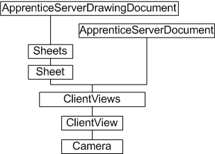

ClientView object model diagram

Creation of a new ClientView object is only possible through Apprentice Server. It is not currently possible to add a new ClientView object within the Autodesk Inventor environment. For example, using VBA to call the Add method of a ClientView object obtained through the Sheet object of a Drawing document will fail.
The ClientView object is always associated with a window handle (hWnd). The ClientViews collection object provides two methods for creating a new ClientView object; Add and AddBySubset. The latter method is likely to be depreciated. The Add method associates a document client view with a given window handle.
