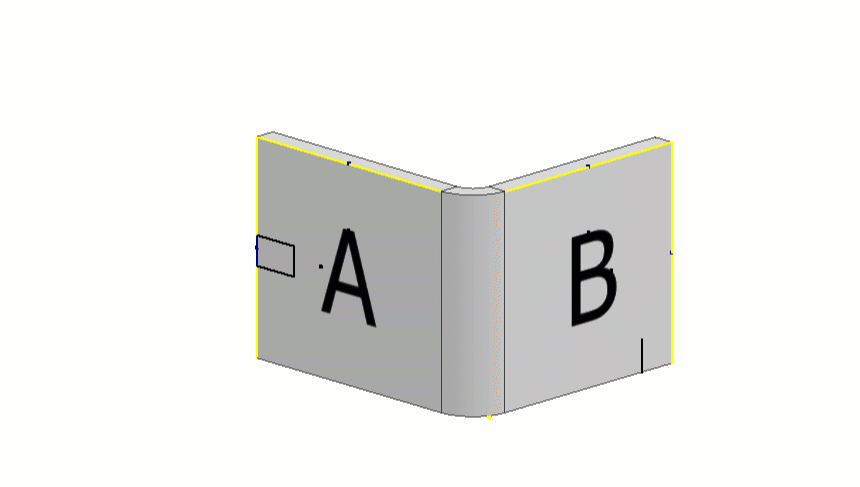

Mark Command, a new feature command for standard and sheet metal parts.
Use sketch text or geometry to add marking features to your models.
Use Mark Styles to control the modeling and export properties of Mark features. Use the Styles and Standards editor to manage Mark Styles.
Export to specific layers in DXF or DWG files.
Check out the new Mark Feature guided tutorial.

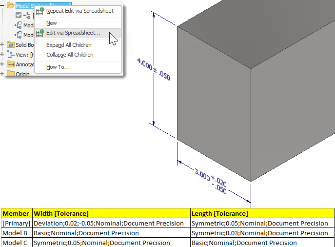

Tolerancing: Model states support the use of unique tolerance settings for each state.

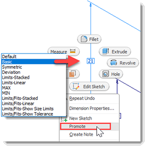

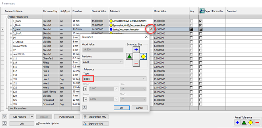

Basic tolerance: The Parameters Editor provides access to the Basic tolerance which can be promoted and synced with 3D annotations in the model and retrieved in drawings.
Basic is also accessible for Sketch dimensions.
If you prefer, you can configure tolerance, text, and Boolean parameters in an Excel spreadsheet and use them in Model states, iParts, and iAssemblies.

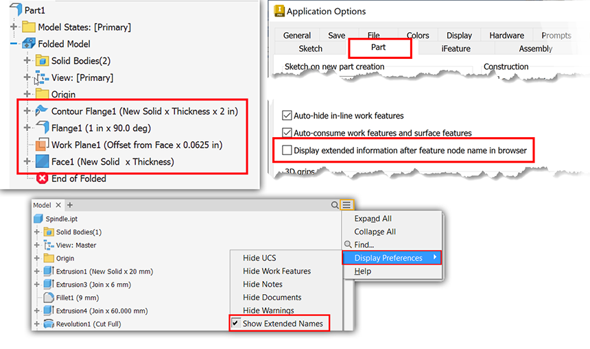

Sheet Metal: Extended browser information is available for sheet metal parts. The option can be activated from the Application Options > Part tab or from the browser node.
A new Sheet Metal Template option is added to Tools > Document Settings > Modeling tab > Make Components Options dialog to select or browse to the template used to create new sheet metal part files.

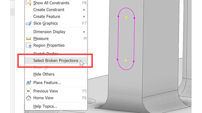

Projected Geometry: It is now possible to select all dereferenced (or sick) projected geometry in a sketch so it can quickly be deleted or looked at for repairing.

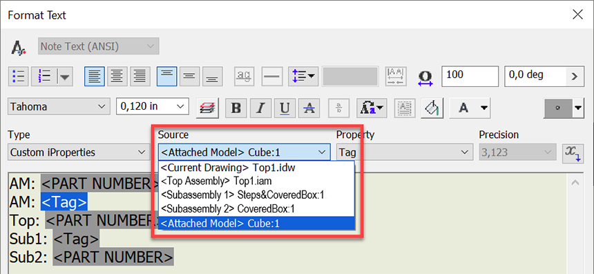

Model Sketch Text: Use Standard iProperties and Custom iProperties from the active model in Part sketch text.

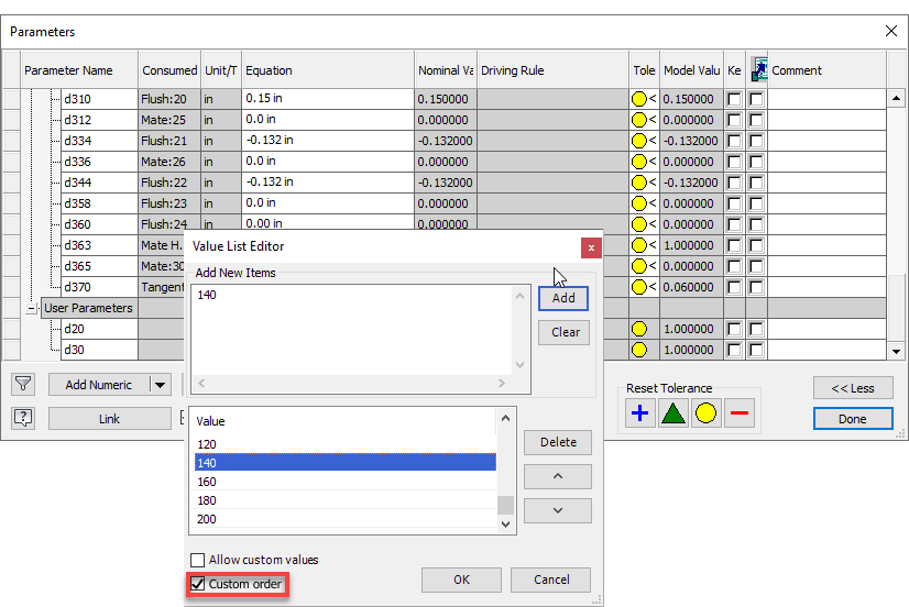

iLogic: You can add external rules and global forms to the ribbon, sort the order of multi-value parameters numerically, and use the Measure.PreciseExtents to obtain more accurate results for curved parts.

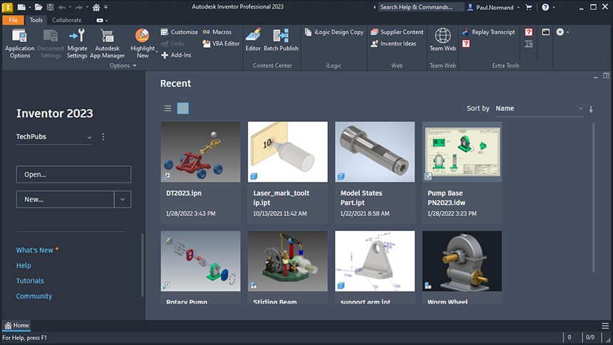

Home Replaces My Home: The redesigned Home page provides a consistent start experience for Autodesk products.

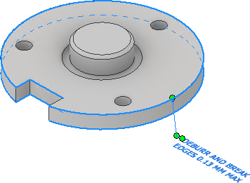

3D Annotation and Model-Based-Definition
The Datum Target command is added to the General Annotation panel so you can establish datums on irregular surfaces.
The Datum Target is added to Styles.
User defined 3DA datum target planes are added.

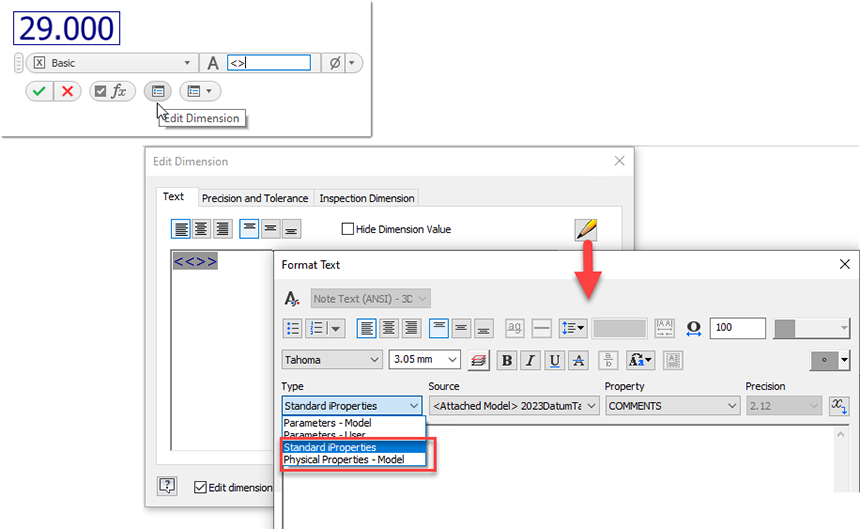

Include properties when adding text to a 3D annotation.

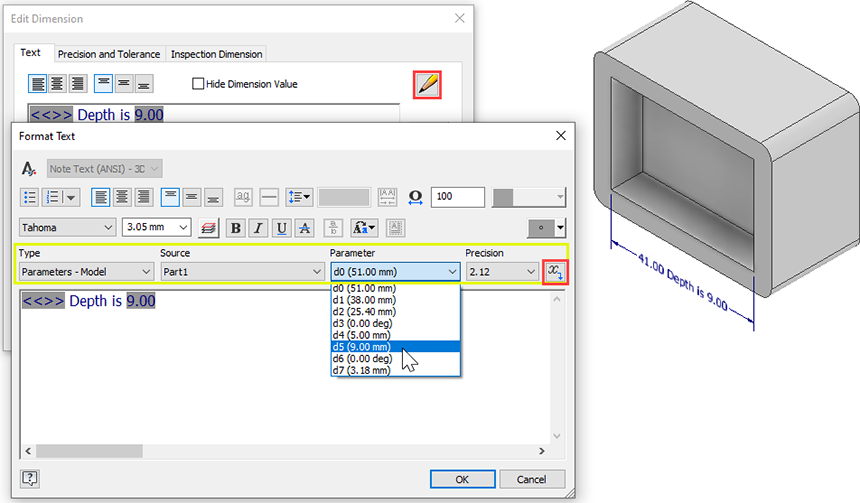

Include Parameters when adding text to a 3D annotation.
Tolerance advisor supports ASME 2009 and ISO 2012.

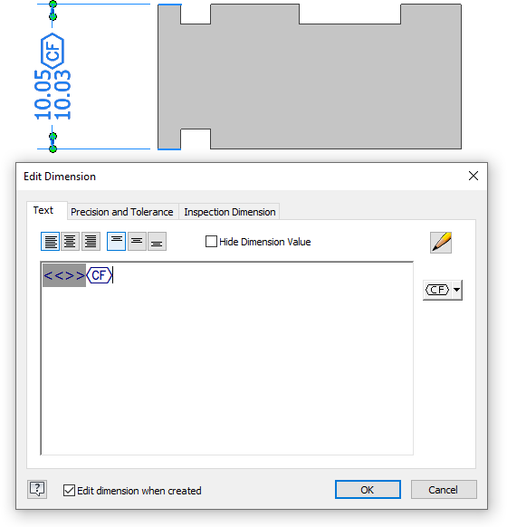

Continuous Feature (CF) is available in the 3DA Edit Dimension and Format Text dialog.

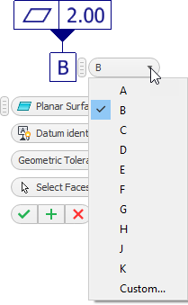

Datum Reference Frame has been refined for ease of use and custom DRF labels.

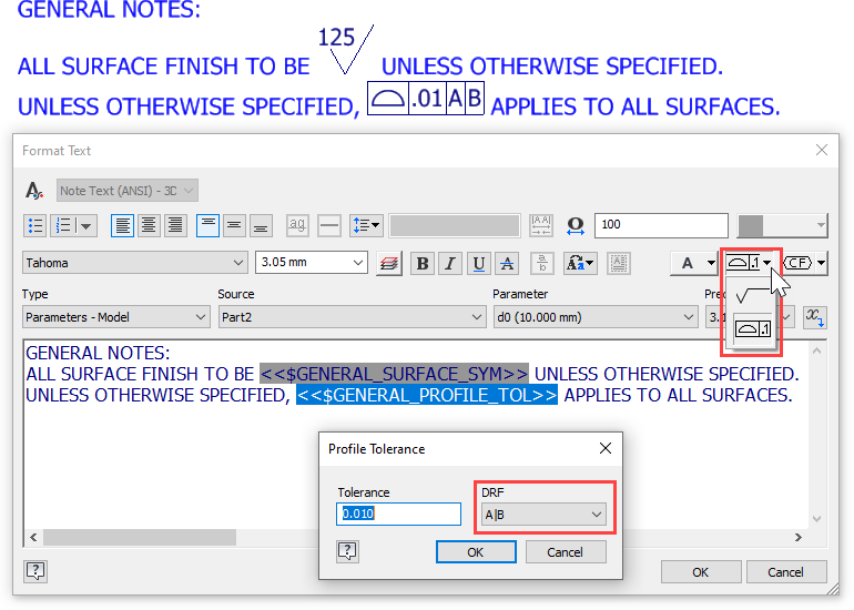

Include general Surface Texture and Surface Profile annotations in notes.
Associate Multiple Faces, Edges, and Vertices with a single 3D Leader Line.

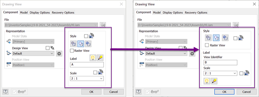

Drawing Views
Use Edit Detail Properties to change the detail view boundary shape from circular to rectangular.

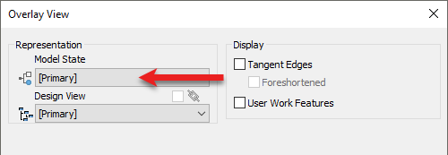

Use model states in connection with Overlay views.
The Drawing View dialog has an updated View label interface.

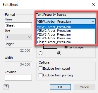

Use the model from any view as the primary property source.

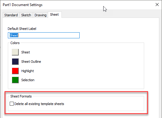

Automatically remove existing sheets when you create a drawing from a predefined sheet format.

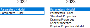

Access any property field for dimensions from the Text Editor.

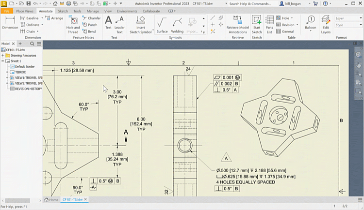

Drawing Annotations
The Surface Texture Collection symbol is added.

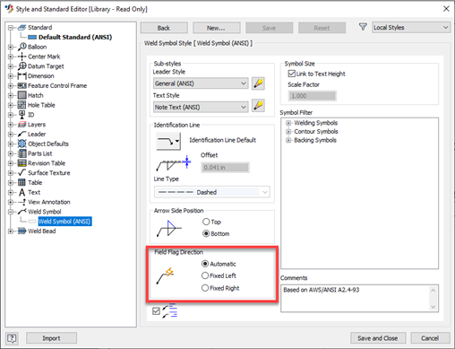

Improvements in the Welding Symbol Identification Line and Field Flag Direction.
A new "Field Flag Direction" option is added to the Weld Symbol Style and Standard Editor dialog enabling you to set the direction of the field flag.
Leader text can now include standard iProperties, custom iProperties, and instance properties belonging to parents of the attached part.

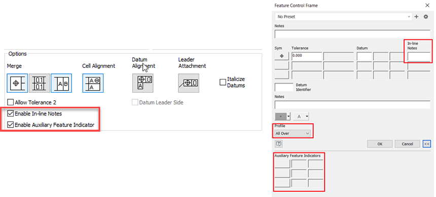

Feature Control Frame: The "All Over" symbol on the Feature Control Frame. Use the new "All Over" option in the Profile drop-down menu in the Feature Control Frame dialog.

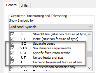

You are also able to enter prefix , suffix and auxiliary feature indicators per ISO 5458 & 5459 standards in the Feature Control Frame dialog. First, enable the options using the new check boxes added to the Style and Standard Editor dialog. Also note that the cells become enabled as you fill the cells in.
Additional identifiers were added to the Feature Control Frame style dialog to comply with ISO 5458, ISO 14405-1:2016, and ISO 1101 standards.
