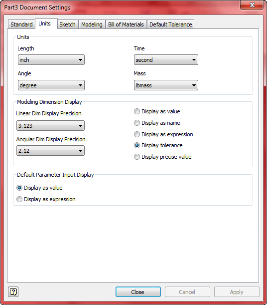

The units of measure portion of the API is a set of utility functions that allow you to perform several types of tasks related to units within Autodesk Inventor. The first of these tasks is getting and setting the current display units and their precision. The display units and their precision are attributes of the document and are saved with the particular document they are set for. The API access to the units and precision is equivalent to the functionality provided in the user interface through the Units tab of the Document Settings dialog, as shown below.
By setting the default units and precision you control how Autodesk Inventor displays all values. For example, if you set the length units to be inches and three decimal place precision, all display of lengths will be in inches and have three decimal place precision. Whenever you need to provide a value for a length, like when specifying the length of an extrusion, and you enter a value without specifying any units, it is assumed to be the default unit. For example if you enter "5" as the length of an extrusion it's assumed to be five inches since that is the default length unit for the document.
