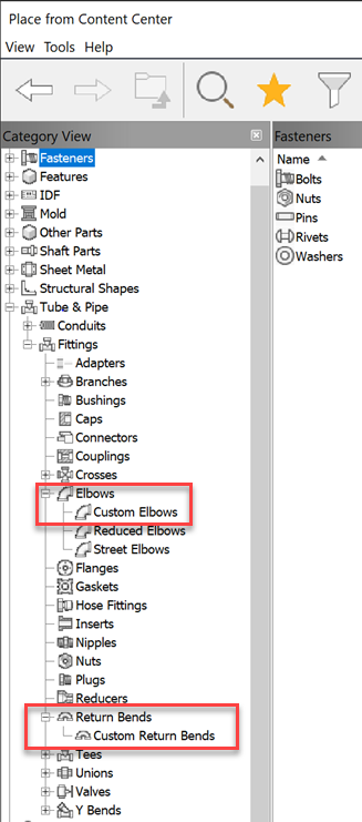

New Custom Elbow Styles
New styles which support the use of custom elbows (Custom Elbow 45, Custom Angle 90) are available in the Tube and Pipe Styles dialog.
Markdown card metadata
Beside the Custom Elbows library, the Custom Return Bends library is also added. Parts from both libraries are supported to be authored and published.
For more information see To create New Tube and Pipe Styles.
For more information see To Author Tube and Pipe Parts.
