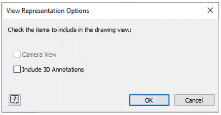

To extract 3D Annotations for projected views, double-click in the view to activate a view edit, then enable Include 3D Annotations in View settings.
This action does two things. It displays the 3D Annotations in the view, and sets the view options for inclusion in a sheet format.
A right-click Retrieve Model Annotations does not enable the view option to Include 3D Annotations for Sheet Formats.

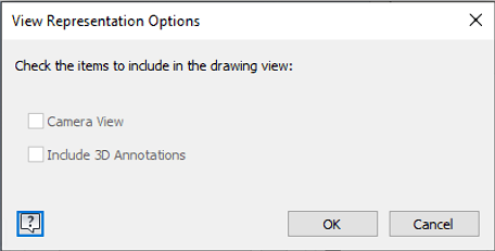

The View Representation Options dialog box is displayed when creating or editing a projected view. The Camera View option is disabled to keep the relationship between the base view and projected view.
Both options are disabled when creating child views, such as Section View and Detail View, when the camera orientation of the child view does not match the orientation of the drawing view being edited.
