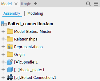

Constraint status now displays by default in the assembly browser as a
, or
to indicate one of three states:
Fully constrained A black dot indicates the component is fully constrained.
Under constrained A hollow dot indicates the component is under constrained and needs attention. To resolve, start by opening the Edit Constraint dialog box to identify possible issues.
Unknown A dash indicates the constrained status of the component is unknown. To resolve this state, rebuild the assembly: On the ribbon: Tools tab
Manage tab
Update panel
Rebuild All

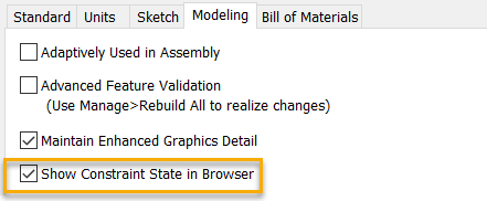

The new setting, Show Constraint State in Browser is also available from Tools
Manage
Document Settings
Modeling tab. By default, the setting is enabled.
