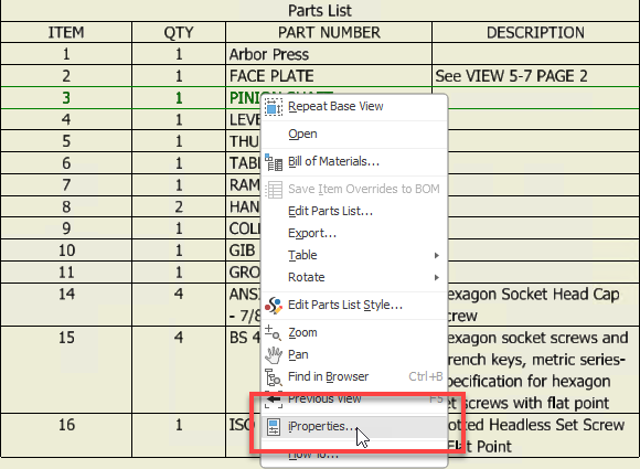

Access iProperties from the Parts List
It's now simpler to edit component properties from the Parts List. Select the component row, right-click, andselect "iProperties".
