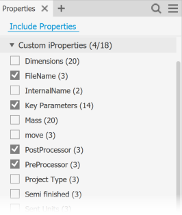

  • Added a ribbon panel specifically for RVT exports, with new commands Include Properties and Simplify and Export. Include Properties displays the properties you can include in the export, providing greater control over the content you share. Select from Custom iProperties, Instance Properties, Standard iProperties, and Factory Properties that you've included in the documents. If you need to add properties later use Edit Properties from the Revit Export node right-click menu, then click Update to commit the changes.
    Note: Include Properties is available for Revit version 2025 and newer.
    Include Properties
    For more information see To Include Properties in Revit Exports

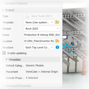

    Simplify & Export is used for RVT exports and is set with default parameters for use with the export.
    Simplify & Export
    For more information see Create a Simplified Part from an Assembly

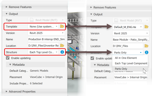

Simplify - New Template and Structure options for RVT export
Simplfy template and structure
  • A new structure option, Parts Only, is added to the RVT export panel. All visible Parts in the simplified assembly get an equivalent Revit element in the exported RVT file. Metadata for the export displays in the panel.
    Inventor Ideas An Inventor® Ideas submission
  • Revit Template (.rte) selection is added to the RVT export panel. When a Revit template is specified, the template version (2024, 2025, etc.) dictates the Output Version of the export. You can use the installed templates from Revit or Revit Interoperability, or use your own custom templates.
    Note: For more information see Simplify Assemblies Enhancements.

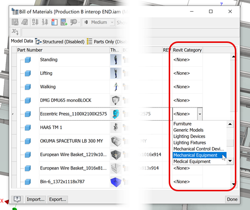

Include Revit Categories wherever iProperties can be included
You can include Revit Categories in Bill of Materials, sketches, 3DA, parts lists, leader text, iLogic and so on - anywhere you use other iProperties.
For example, in a Bill of Materials use the BOM Editor Column Chooser to add Revit Categories to the table. In the item row, in the Revit category column, begin to enter the category and the list of Revit categories displays. Select the one that applies. If you want to assign the same category to multiple items, just copy the one property and select multiple cells, then paste. All selected cells update to use the property.
BOM Editor
For more information see To Work with Bill of Materials and To Customize BOM Columns.
