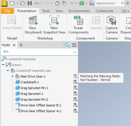

Presentation Enhancements
In this release of Inventor, the ability to search dependent document iProperties in the IPN file type has been added.
You are now also able to select a desired Model State. Right-click the scene, select Representations from the context menu, and then select the model state.

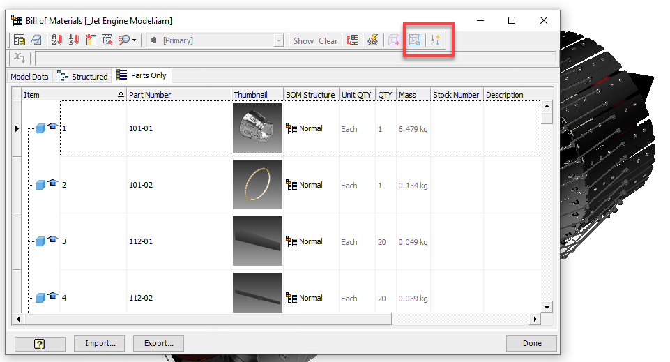

New Zero Quantity Toggle in Bill of Materials
The Bill of Materials dialog has been redesigned. Two options to show or hide items with zero quantity are added directly to the toolbar. Use the new Hide/show rows with zero quantity toggle in the toolbar. When active, you can also renumber the order sequentially using the new Automatic re-numbering sequentially toggle.
Toggles the ability to show or hide items with zero quantity. Note: This is affected by the suppression of components in model states.
Enables or disables the automatic re-numbering of items sequentially. Note: This option is enabled only if the Hide/show rows with zero quantity toggle is on. When ON each model state could have it’s own unique BOM numbering.
For more information see Bill of Materials Reference.

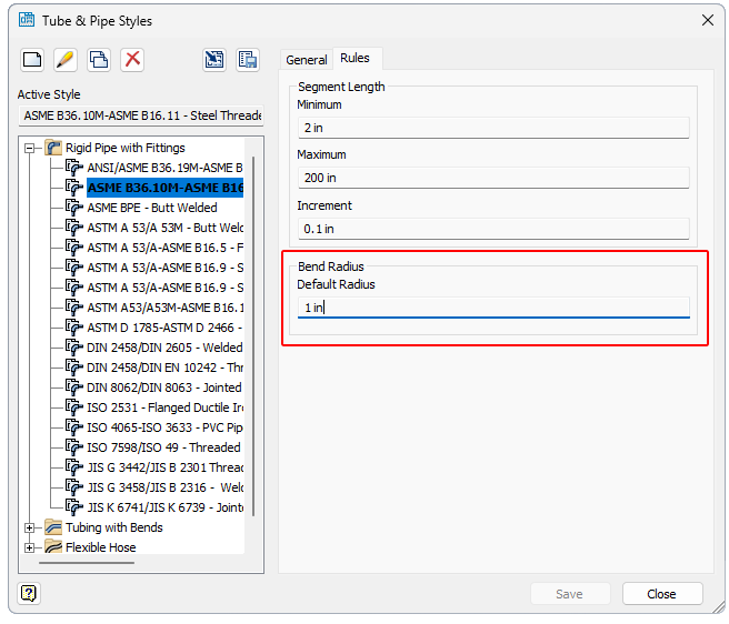

Tube and Pipe Enhancements
Now, all default Bend Radius values are saved into the exported Tube and Pipe style. The bend radius in T&P style can be exported to XML file, and it can also be imported.
