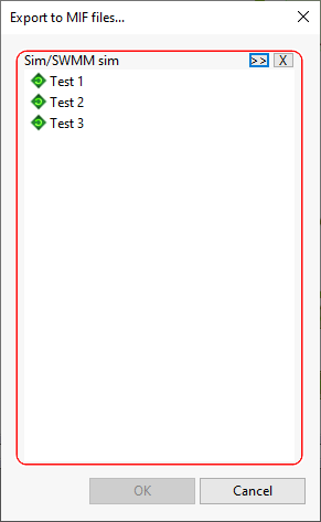

The Export to GIS Dialog is used when exporting results to GIS format. The dialog is used to select the simulations for which the results will be exported.
The dialog is displayed when an export option is selected from the Results | Export to GIS submenu.
Show me
Drag one or more simulations from the tree view to the Sim/SWMM sim drop target or use the
button to browse for a simulation.
Click OK to display a standard Windows select folder dialog. When the export destination folder has been selected, the GIS Export Dialog is displayed. Set options on the GIS Export Dialog as required and click OK to export GIS files containing results of the simulations(s) to the specified folder.
