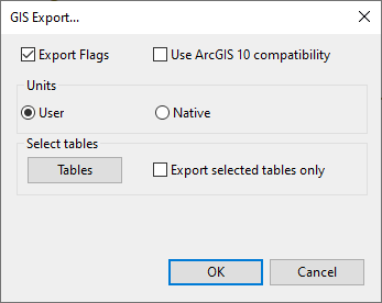

This dialog is used when exporting networks , simulation results, risk analysis simulation results or risk analysis result objects to one of the following GIS formats:
  • MIF
  • TAB
  • SHP
  • Geodatabase (only available in 32 bit versions of InfoWorks ICM)
GIS Export (exporting from a network)
GIS Export (exporting simulation results (InfoWorks networks only))
Dialog description
Item Description
Export Flags
Displayed when exporting networks only.
Check this option to export flag data.
Use ArcGIS 10 compatibility
SHP file export only
If checked, a direction check on polygons is performed to ensure that all exported single-part polygons are specified anti-clockwise. (Various features in ArcGIS 10 require single-part polygons to be specified anti-clockwise.)
Skip Empty Tables
Geodatabase only
If checked, empty tables will be excluded from export.
Units Export using InfoWorks ICM Native Units / current User Units

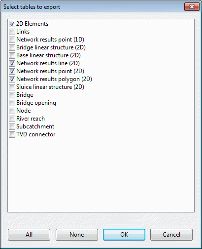

Select tables
If checked, export is restricted to a selection of tables.
The tables to be exported can be selected when you click Tables. This displays the Select tables to export dialog.
Check the boxes next to the tables to be exported. Use the All and None buttons to select or deselect all tables in the list.
