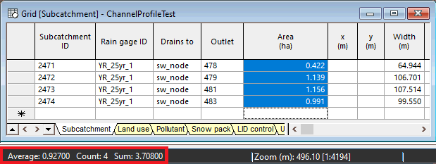

Displaying the sum and average value of selected cells
To display the sum and average value of relevant numerical object properties, such as area or population, in the status bar:
- Select either the Autosum option from the Grid
menu or click
(Autosum) on the Modelling Grid Windows
toolbar.
- Select the cells for which you want this information displayed.
The number of selected records, as well as the total and average of the selected values, are displayed in the status bar.
Example
The Autosum option is a toggler that can be turned off by selecting it once more.
