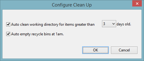

Configure Clean Up dialog
The Configure Clean Up dialog is used to set options for automatic cleaning of the working directory and remote results root.
The dialog is displayed by selecting the Configuration | Clean Up menu option in the Administrator mode.
Item Description
Auto clean working directory for items greater than <x> days old Check this option to clean the working directory on the user's workstation. Only items greater than <x> days old will be cleaned, where a value of x from 1 day to 30 days may be selected.
Auto empty recycle bins at 1 am Check this option to remove files of simulations marked for deletion from the remote results root daily. A run is marked for deletion once its status is set to Marked for deletion in the Run Admin window.
