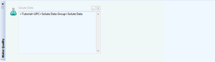

Water Quality Options window
The Water Quality Options window is used to specify one or more solute data objects for Water Quality simulations.
The solute data objects specified in this page can be used when creating a new water quality incident or response runs in the Operator. Projection runs use the solute data from the default simulation (simulation specified in the Default Model page of the baseline). If the base simulation has a solute object then that will always be available and will be used in projection runs. This allows alternatives to be offered when the user creates incident or response runs.
