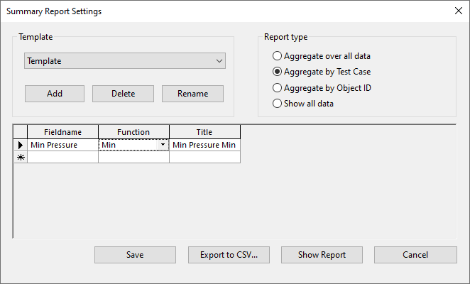

This dialog is used to display the report summary from the analysis of the
Generalised Multi Run (GMR) Configuration.
The dialog is displayed by selecting
Open as > Summary report settings from the context menu of GMR results.
Item
Description
Template
Default
Default template available in the drop-down menu. This cannot be deleted.
Add
Adds new template with a set of report settings.
Delete
Deletes a template.
Rename
Renames a template.
Report type
Aggregate over all data
Displays the sum of the test cases and object IDs functions.
Aggregate by Test Case
Displays the function by test cases.
Aggregate by Object ID
Displays the function by object IDs.
Show all data
Displays all data that has been set and calculated.
Grid
Fieldname
Function
Title
Select a field name from the drop-down menu.
Select a function from the drop-down menu.
The title of the function that will be displayed in the report.
Buttons
Save
Saves changes to the report.
Export to CSV
Exports the report to a CSV file.
Show Report
Shows the report in a new window.
When aggregation is enabled for GMR summary reports, the Test Case and Object ID are reported for which the minimum or maximum value occurs.
Cancel
Cancels the report.
