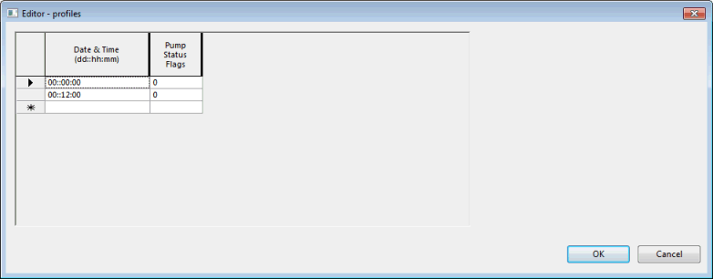

Editors are grids or profiles that are displayed when the
button is invoked for a field in the
Fields page of the
Baseline Property Sheet (The fields present on the editor depend on the selected network / database object).
Note: It is important to highlight that whenever a date / time column is present, the date(dd) is relative to the simulation whereas the time (hh:mm:ss) is absolute.
Editor data can only be edited:
- If they related to a checked-in network and checked-in control.
- In a checked-out baseline.
