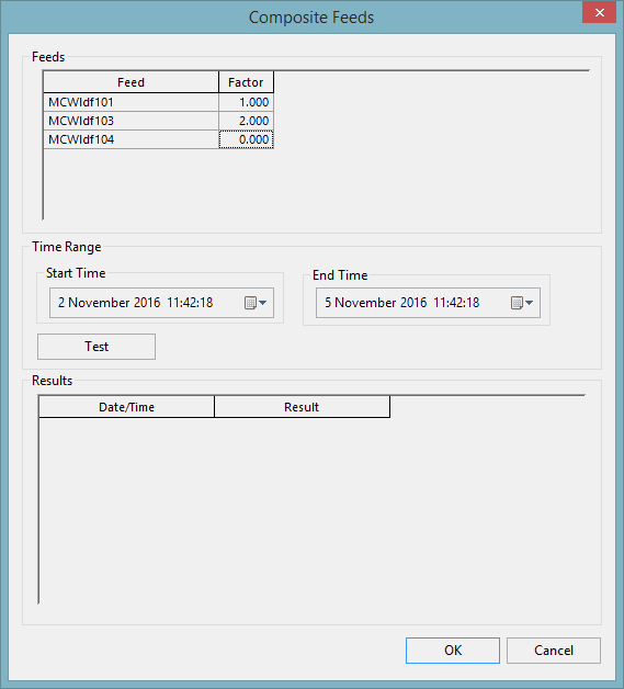

The Composite Feeds dialog can be used to combine feeds into composite feeds. A number of primary feeds are combined by addition and subtraction, by using a multiplier factor. Interpolation is used if time steps do not coincide.
To display the dialog:
- Right-click a feed name or feed count in the Live Data Composite Feed view and select Feeds from the context menu.
- Right-click a feed name or feed count in the Live Data Composite Feed view and select Properties from the context menu. In the Live Data Composite Feed object properties window, select Feeds.
| Field | Description |
Feeds |
Feed - This column contains the list of available feeds, as specified in the Live Data Feed View. Factor - Enter multiplier factors for each feed to determine the composition of the composite feed. |
Time Range |
Start Time and End Time - Specify date/ time range over which the enabled feeds are to be tested for. Test - Click this button to test the composite feed with live data. The results will be displayed in the Results grid. |
| Results |
Displays a grid with the returned results for the time period set in the Time Range section. |
| OK |
Click to close the dialog. |
