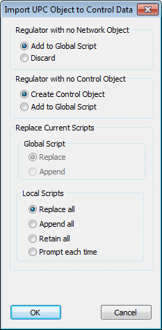

Import UPC Object to Control Data dialog
This dialog is used when importing a UPC scenario into a control data object. The UPC scenario controls are converted into UPC script.
The dialog is displayed when a UPC scenario is dragged from the Model Group window or the Explorer window to a network with associated control.
Show image
Option Description
Regulator with no Network Object
Select an option for the action to be carried out if the UPC scenario contains controls for an object that does not exist in the current network:
Option Description
Add to global script
Script is added to the Global UPC Script in the Global UPC Script view .
Discard
The UPC scenario controls for the object are not imported.
Regulator with no Control Object
Select an option for the action to be carried out if the UPC scenario contains controls for a regulator that does not have Control Data in the current control:
Option Description
Create control object
Control is added to the network object and the UPC scenario controls are converted and imported into the local UPC script on the UPC Script page
The UPC scenario controls are converted and added to the Global UPC Script in the Global UPC Script view
Replace Current Scripts
Select an option to be used when importing scripts into control data with existing UPC scripts.
Global Scripts
Option Description
Replace
Replace current scripts in Global UPC Script view.
Append
Append scripts to current scripts in Global UPC Script view.
Local Scripts
Option Description
Replace all
Replace any current local UPC scripts.
Append all
Always append scripts to current local UPC scripts.
Retain all
Do not make any changes to current local UPC scripts.
(Control data of objects that do not have a current local UPC script will be updated with the imported script.)
Prompt each time
Displays the Import UPC Object to Control Data dialog, allowing current and generated scripts to be viewed before selecting whether to replace, append or retain current scripts.
(A prompt will not be displayed for objects that do not have a current local UPC script.)
