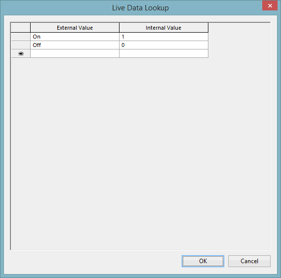

Editor layout for scalar lookup
This an example of mapping for pump status where 'On' has been translated to 1 and 'Off' to 0.
Live Data Lookup Editor for scalar lookup
Item Description
Left-most column
If clicked, selects the whole row.
An asterisk indicates where a new mapping can be created by entering its details.
Fields
External Value
Value in the telemetry database.
Internal Value
Corresponding or translated value, to be used by InfoWorks WS Pro or IWLive Pro Operator Client.
Context menu
Cut / Copy / Paste Normal clipboard actions.

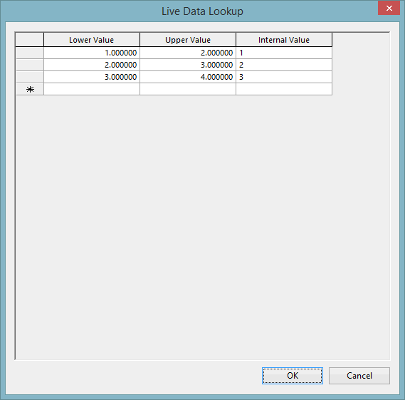

Editor layout for range lookup
Live Data Lookup Editor for range lookup
Item Description
Left-most column
Fields
Lower Value
Range bottom value.
Upper Value
Range top value.
Internal Value
Context menu
The following test is used for each range:
Lower value <= External Value < Upper value
This means that the lower value is included in the range, but not the upper value. This makes it easier when defining consecutive ranges, e.g. 1-2, 2-3, 3-4. The value 1 will fall in the range 1-2, the value 2 in the range 2-3 and the value 3 in the range 3-4.
A validation message is generated if ranges overlap. See Validating live data for more information.
