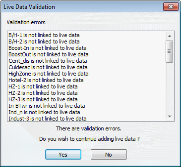

The Live Data Validation dialog is displayed when a new Saved Graph is opened which has associated live data.
The following warning messages may be displayed in the dialog:
- object to be graphed is not linked to live data
- live data point associated with object to be graphed does not exist in Live Data Configuration
- live data file could not be found
- selection of objects to be graphed contains objects of different type to those selected on the Saved Graph Data - Style and Data Page
Click Yes to graph live data where possible. Click No to plot graphs without live data.
Show image
