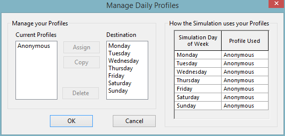

When the Manage Daily Profiles dialog is first opened, the current demand category is assigned the name of "Anonymous" and is shown in the Current Profiles section. This default profile has been assigned to all seven days of the week as can be seen in the How the Simulation uses your Profile grid.
To add the first daily profile
The steps for defining a seven day profile are as follows:
- Select the Anonymous profile in the Current Profiles box
- Select a day of the week in the Destination box to which the Default profile is to be assigned. More than one day of the week may be selected.
- Click the Assign button. The Default profile is copied to create a new profile for the days selected. The new profiles are given the name of the selected days and appear in the Current Profiles box. The Default profile is then removed because it is no longer needed.

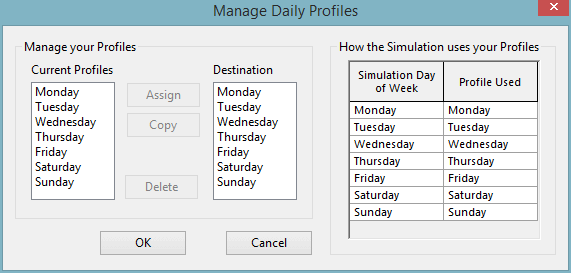

Demand profiles may be set up in this way for every day of the week. Show image

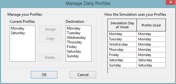

Alternatively, demand profiles may be set up for selected days of the week. In this case, the demand profile will be used for each day of the week until the next defined demand profile. For example, if a Monday profile and a Saturday profile are set up, the Monday pattern will be used for Monday to Friday inclusive and the Saturday profile will be used for Saturday and Sunday.
