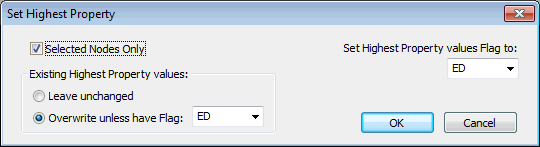

This dialog is used when setting the highest property at each node.
The dialog is displayed by selecting Model
Set highest property. If the menu option is unavailable, it is because the current network is using the lock method of version control and is not checked out.
| Item | Description | ||||
| Selected Nodes Only | If checked, only the nodes currently selected on the network will have their highest property values set. | ||||
| Existing Highest Property values |
| Set Highest Property values Flag to | If you enter or choose a flag in this box, all the changed highest property values will have this flag set against them. |
