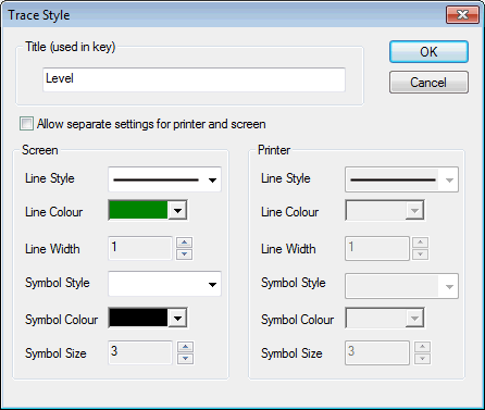

    Changing trace properties
    You can change the colour, line thickness, and line symbol for all traces on your graph. InfoWorks WS Pro allows you to set different properties for on-screen viewing and printing if required.
    1. Double-click any trace on the Graph view, or open the Graph Properties dialog and then double-click any trace on the Traces page.
      This opens the Trace Style dialog.
    2. Make the changes.
    3. Click OK.
