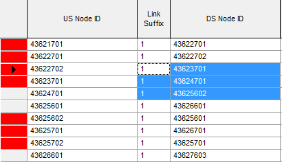

When you select a row on a network grid view the network object it represents becomes selected.
Selected network objects are represented by a red box in the left-most column of the grid.

The picture above shows a number of selected network objects (red markers) with a separate block of selected cells.
