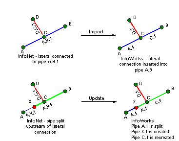

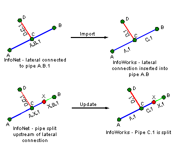

Pipe Splitting |
Pipe split downstream from a lateral |
A new pipe is created downstream from the lateral. Example
| Pipe Splitting |
Pipe split upstream from a lateral |
A new pipe is created between the inserted node and the lateral. The new pipe and the pipe downstream from the lateral will be updated with the properties of the newly created pipe in InfoAsset. Example
