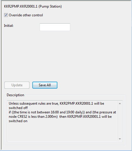

| Regulator pane
A regulator marks the start of a block of records defining the operation of one regulator structure in the system. Regulators in
InfoWorks WS Pro are always valves or pumps. The block can contain rules and local definitions of control point ranges and logic rules. Show pane
Override other control (checkbox)
If checked, the regulator definition overrides any control data defined for the network object in the control data set.
If unchecked, the regulator definition is disabled and will be ignored. Controls defined for the network object in the
control data will be used.
Note: In the left pane of the UPC window, the regulator text is highlighted red if this checkbox is unchecked, and green if it is checked.
Initial
For valves: Initial opening (%). If the initial opening of a valve is left blank, an initial opening of 100% will be assumed.
For fixed speed pumps: ON (greater than zero) or OFF (less than or equal to zero). For variable speed pumps: Speed. If the initial status of a pump is left blank, the pump will be assumed to be OFF initially.
Description
A text description of how the regulator will operate. This description is built up from all the ranges, logic operators, controllers, tables, variables, and rules defined for the regulator.

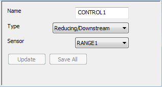

| Controller pane
Controllers indirectly control a regulator in order to achieve a defined setpoint. Show pane
Name
A label that identifies a controller.
Type
This field is applicable only to pressure controlled valves, and describes the controller reaction to an input signal.
Reducing/Downstream: controls valve as a PRV - increase opening if below target and vice versa (default)
Sustaining/Upstream: controls valve as a PSV - reduce opening if below target and vice versa
Sensor
A control point (node or pipe) range that is used to provide the input signal to a controller. The controller will be ignored if the sensor does not point to a valid range or the measurement range is not greater than zero. Only range types of Q-Flow, P-Pressure and Z-Head can be used as the sensor for a controller.

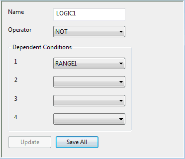

| Logic pane
You can combine the output from up to four range or logic operators to give a TRUE or FALSE result. This result can be used as the input to either another logic operator or a rule.
If logic operators are defined under the global object, any regulator definition can access them. Logic operators that are part of a regulator definition are local to that regulator definition. A local definition is used in preference to a global definition with the same label. Show pane
Name
The label that identifies the result of this logic definition.
Operator
A logical operator:
AND
All conditions must be TRUE for the result to be TRUE. Otherwise the result is FALSE.
OR
At least one condition must be TRUE for the result to be TRUE. Otherwise the result is FALSE.
NOT
If the first condition is FALSE the result is TRUE. Otherwise the result is FALSE.
NOR
If all conditions are FALSE then the result is TRUE. Otherwise the result is FALSE.
NAND
If any condition is FALSE then the result is TRUE. Otherwise the result is FALSE.
Dependent Conditions (1 to 4)
Input conditions. Each of the conditions is either the label of a previously-defined range or logic definition, or it is left blank. At least one input condition must be given for the NOT operator and at least two for all other operators.

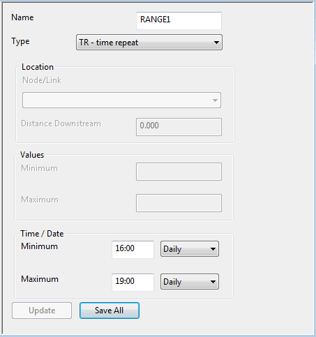

| Range pane
Ranges provide a logical output which is TRUE if the control point variable is within the defined range (between defined minimum and maximum values) and FALSE if it is outside the defined range. You can define the variables at any point in the system; they do not have to be local to a regulator. Show pane
Name
A label to identify the range.
Type
The range type. Using an invalid range type will result in the range being ignored.

Location
Specifies the control point for this range. This should match the label of a node or link in the network. If not, the range will be ignored.
The Distance Downstream field is not used and is always disabled.
Values
Minimum: Minimum numeric range value. If blank, the value defaults to minus infinity.
Maximum: Maximum numeric range value. If blank, the value defaults to infinity.
Time/Date
Minimum: If blank, the time defaults to the start time of the simulation. A time range should start on a major timestep.
Maximum: If blank, the time defaults to the end time of the simulation.

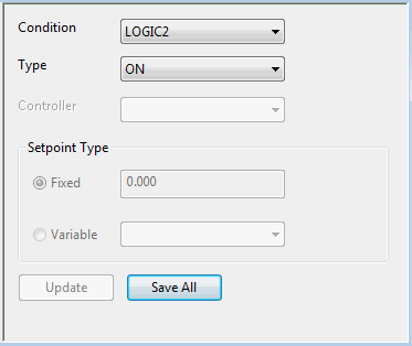

| Rule pane
A rule controls the status of a regulator. When the conditions on which a rule depend are TRUE the rule takes effect. Show pane
Condition
The label of a range or logic condition previously defined for this regulator or included in the global definitions.
The condition can be set to _default_. A default rule should be defined before any other rules. The default rule is assumed to be TRUE.
The last TRUE rule for a regulator will be the active rule at a particular time during the simulation.
Type
The rule type defines the way in which the rule operates on the regulator. Rule types are:
Ctrl
Control
This rule uses a local controller.
POS
Position
This rule directly sets a value of the local regulator setting (speed or opening).
ON
Switch on
This rule can be used only with pumps.
OFF
Switch off
Controller
For a rule using an indirect control this is the label of the controller to be used. The controller record must have already been defined for this regulator or in the global section.
Setpoint Type
Fixed: For a control rule using a controller or for a POS rule this is the required value of the setpoint.
Variable: The name of a previously defined range, variable, or table whose value is used as the setpoint.

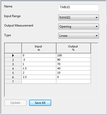

| Table pane
A table allows you to translate measured input values from the control point to new output values. The input values can be the output from a range, table, or variable. You can define a table within the global section or in regulator definitions. The only limit to the number of tables you can define is the amount of computer memory available. Show pane
Name
A label that uniquely identifies the table.
Input Range
The name of a previously defined range, table, or variable. The input range defines the control point at which input values are measured.
Output Measurement
The type of output data to be used as a regulator setting or controller setpoint.
Type
Linear -
InfoWorks WS Pro uses linear interpolation between the defined output values in the table data grid.
InfoWorks WS Pro linearly extrapolates from the first two values if the input value is less than the first table entry, or from the last two values if the input value is greater than the last table entry.
Step - No interpolation is applied to the output values.
Table data grid
Define the table data here. Enter input values in ascending order. Enter a corresponding output value for each input value. The number of records in a table is limited only by the available memory.
Input
If the input range is a time or time repeat range, you enter values here as a date and time (dd/mm/yy-hh:mm).
For a daily range, enter the time (hh:mm) and leave day, month and year as zero.
For a weekly range, enter the time (hh:mm) and day (dd). Enter 01 for Monday, 02 for Tuesday and so on. Sunday is 07. Leave month and year as zero.
Output
Corresponding output value. This will be used as a regulator setting or a controller setpoint.

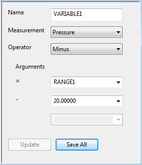

| Variable pane
A variable allows you to combine values (from a range, table, logic operator, variable, or constant value) to derive another value. All variables are set to zero at the beginning of a simulation. Variable values are preserved from timestep to timestep, so you can use them to accumulate statistics. Variable elements are processed in the order in which you enter them. Show pane
Name
An identifier for the variable. This must not be the same name as a range, logic operator or table. However, you can have several variables with the same variable name; the program evaluates them in the order in which they appear in the scenario.
Measurement
The type of data being measured.
Operator
An operator to determine the way in which values will be combined.

Arguments
The values to be combined.
| Argument type
Value
Number
Number
Range name
Range's current value
Table name
Current value from table
Variable name
Variable value
Logic
0 (FALSE) or 1 (TRUE)

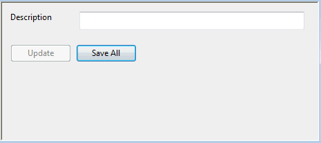

| Description pane
This pane is used for adding a title to the UPC scenario. Access the pane by clicking the Global record. Show pane
Description
The title for the UPC scenario.

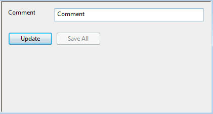

| Comment pane
This pane is used for adding a remark, as a reminder of the effect of the components. A comment can be inserted at any point in the scenario. Show pane
Comment
A remark relating to the current scenario, a regulator, or a component.
