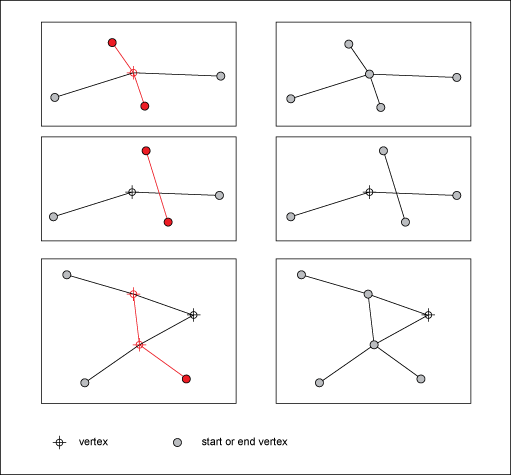

The AutomaticLineSplitAtVertex feature rule splits a line at a vertex when you use this vertex to digitize a new line. For example, when you digitize topology edges.

Splits a line at a vertex when you use this vertex to digitize a new line.
