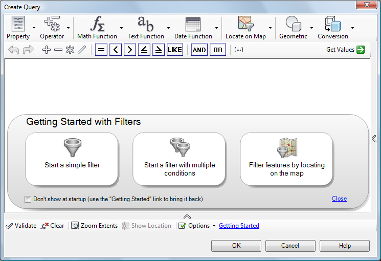

In practice, you specify the data set by selecting the feature class or layer to query before you build the expression. You specify the action to apply when you select the command that lets you build the expression. For example, in AutoCAD Map 3D toolset, select Add To Map With Query or Search To Select.
The title bar for the dialog box in which you create expressions is different, depending on the command you choose. The contents of the dialog box are much the same, no matter what it is called.
Use expressions to filter geospatial data, select a subset of data, calculate values, or convert data from one data type to another. Use text expressions to format text strings for display, for example, as labels. Use numeric expressions to apply math functions to properties with numeric values.
The text in the title bar changes, depending on which command you select.
