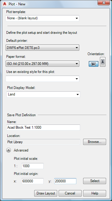

  4. Create a new plot.
    • Use the settings shown below.
    • Click Draw Layout to open the plot for editing.
    • Close all open drawings except the one that contains the newly created plot.

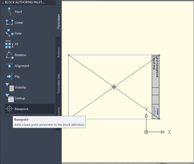

  5. In the newly created plot drawing, type BEDIT to open the AutoCAD Block Editor.
    • Create a new AutoCAD block that is 297 units wide and 210 units tall (A4).
    • Set the block’s base point to its center.
    • Close the block editor.

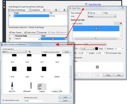

  6. Style the layer PLT_PLOT_DECORATION.
    • In the Display Manager, select the layer and click Style.
    • In the Style Editor, under Point style 0 - Infinity Scale Range, click the browse button in the column labeled Style.Set the parameters as follows:
      • Symbol: Select the block you just created from the current drawing.
      • Size Context: Map space
      • Units: Meters
      • Width: 297 (A4, 1:1000)
      • Height: 297 (this is set automatically when you set the width)
      • Fill color: Keep the original color.
      • Edge Color: Keep the original color.
      • Rotation: Enter the expression ORIENTATION * 0.9 + 90
  7. Save the current display model, overwriting the existing plot display model.

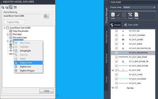

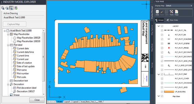

  8. Digitize a new plot point decoration feature, as shown below.

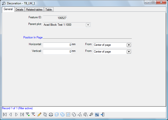

  9. Open the generic form for this point feature, and set its position to the center of the page, as shown below.
    Once updated, the AutoCAD block will be centered on the paper.
    The point decoration feature is styled using the AutoCAD block you created. This AutoCAD block has its base point set at its center. Because the point decoration feature is centered on the paper, the AutoCAD is correctly positioned.

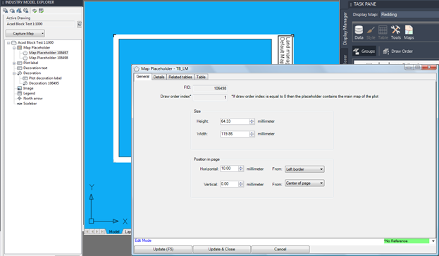

  10. Optionally, create a (primary) map placeholder and set it to a pre-defined width and position.
    • Capture the map for this map placeholder.
    • Specify an existing display model.
    • Apply a rotation value, if necessary.
  11. Optionally, extend the plot by adding a label for the plot’s scale, an overview map, and any other desired elements.
    The plot shown here is scaled at 1:1000.
