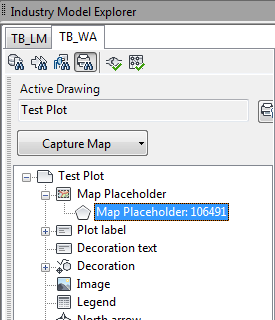

  9. Capture the map.
    In the Plot Explorer task pane, under the Map Placeholder node, select the new Map placeholder which you have just created. Click Capture Map.
