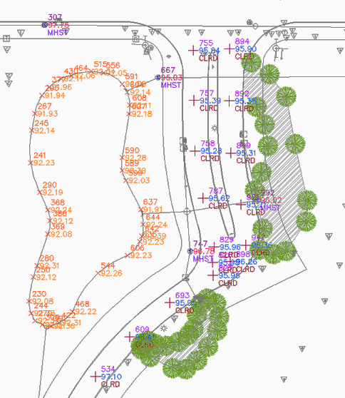

This illustration shows points representing different features, imported from AutoCAD Civil 3D.
